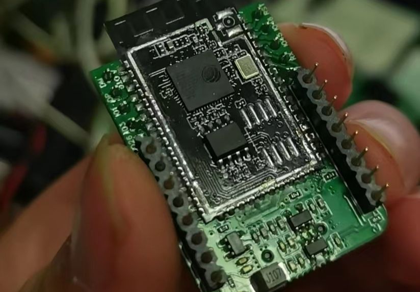

【Development Board】ESP32-CAM-12K (S2 and S3)
The ESP32-CAM development board with Essence ESP32-12K/ESP32-S3-12K as the core has an additional 10 pins.
The power ground wire and serial port pin positions are compatible with ESP32-CAM. It is equipped with ESP32-S3-12K module and is connected to OV2640 camera, which can exceed 25fps at 1024*768 resolution.
You can attach 12K (S2 chip) or S3-12K (S3 chip). It is recommended to attach S3-12K. The corresponding relationship is marked in the pin schematic diagram of the two modules. The PCB silk screen pins are marked as 12K (S2 chip) module pins.
If you attach a 12K module, please refer to the camera pin definition.

Essence has discontinued the ESP32 module. I have reproduced an S3-12K module for reference: https://oshwhub.com/njbinbin/esp32-s3-12k-clone_copy , but it is not recommended to be used with the official product. Its pins It is not fully compatible with the original 12K. If the OTG pin connected to this development board is used as a DVP camera and is therefore unavailable, the silk screen pin markings on the development board will no longer apply. The pin correspondence is as follows:
GND VCC 00 01 09 03 04 11 13 14 08 05 10 06 12 07 02 38 39 17 18 19 20 21 48 GND 33 34 35 36 37 15 16 40 41 42 TX RX 45 46 EN GND
GND VCC 00 03 05 07 09 06 10 08 11 12 13 14 15 16 17 18 19 20 21 48 34 36 33 GND 35 37 38 39 40 04 41 42 45 46 TX RX 02 01 EN GND

renew:
A special PCB has been added for attaching the replica S3-12K module, and the OTG pins have been adjusted. The pin definitions are as follows:
