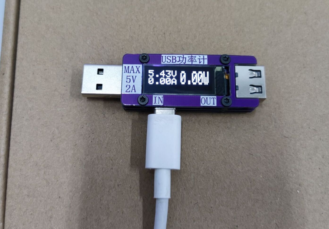

* 1. Introduction to project functions:
Small, easy-to-use and exquisite USB power meter
* 2. Project attributes:
Jiali Chuang Summer Training Camp 2022
* 3. Open source agreement:
GPL3.0
* 4. The hardware part
is designed with reference to the training camp routine (5V);
a USB-C port input is added for easy use;
the onboard 0.91-inch OLED screen makes the entire USB power meter more compact (measured three-dimensional approximately: 67mm*20mm*10mm);
the designed 5V version, so a 5V2A self-recovery fuse is placed for overcurrent protection.
* 5.
Burn the official routine for the software part (I don’t know how to modify the code yet...)
