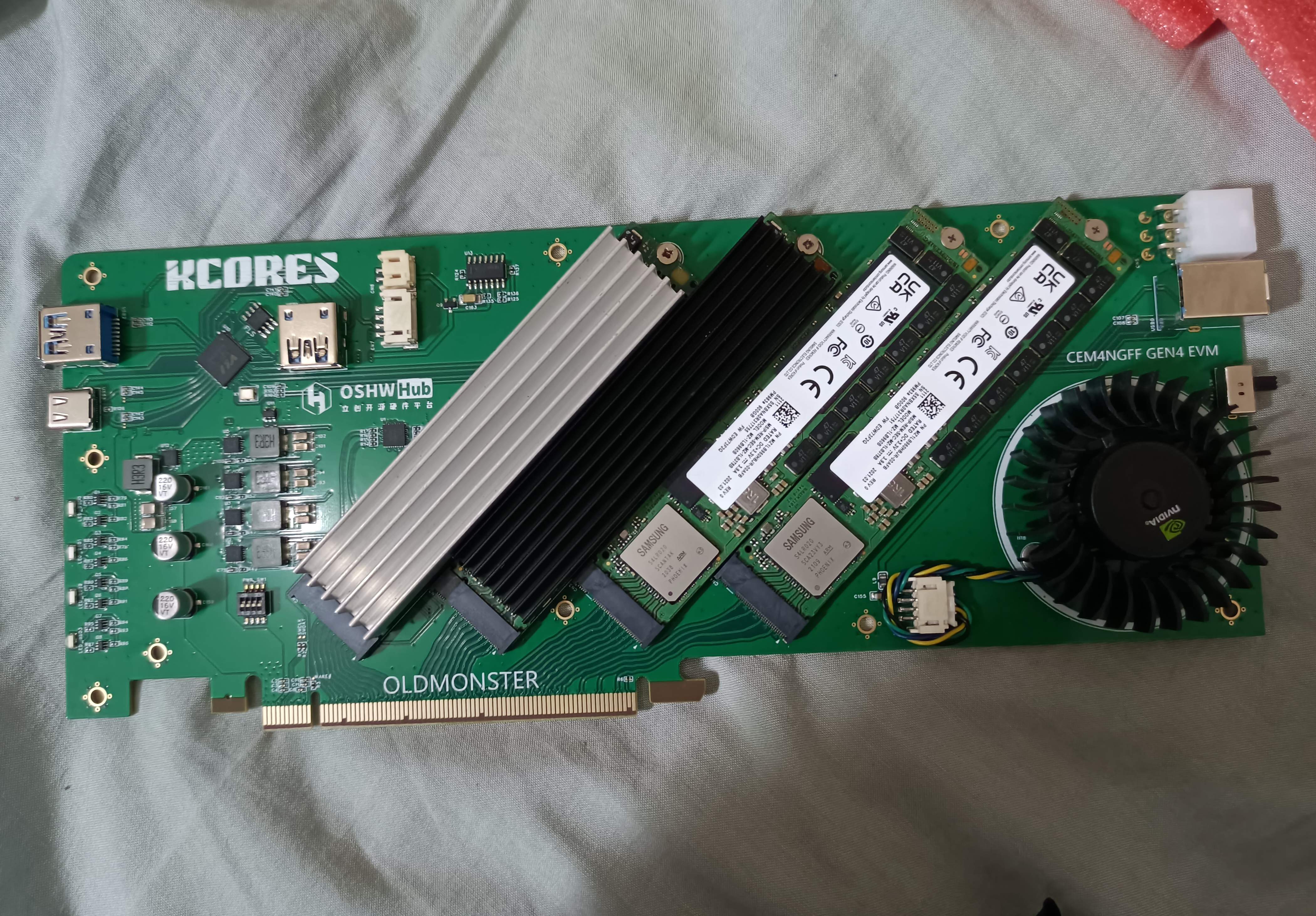

To split the 16 PCIEX16 lanes of the computer motherboard into four 4-lane lanes, the motherboard needs to support PCIE splitting.
Each channel enjoys full speed of X4 (whether it is PCI-E 3.0 or PCI-E 4.0 depends on your motherboard).
The PCIE clock uses Texas Instruments' LMK00334RTVR clock cache chip. The Buffer has four channels for four SSDs. (Currently, ICS and PIC clock cache chips are out of stock and high prices. Lichuang Mall has this TI chip. The wiring and resistor usage of this chip are relatively strict. )
Each M.2 SSD interface is powered by Texas Instruments' TPS54620RHLR all-in-one BUCK chip to provide a maximum current output of 3.3V 6A for each port (because it is a test, I used TI's, which is still relatively expensive. Students who copy homework can Replace it with a cheap one, or even a foreign junk module like PW22A) to meet the needs of high-power M.2 SSD.
And the reset signal with PG signal and PCIE provides an independent reset signal to each M.2 port through a single dual-input positive AND gate. It adopts PCIE full-length and full-height design and supports four 22110 length M2 SSDs.
The TYPEB at the back is connected to the USB3.1/USB3.0 interface of the motherboard. The bezel supports one 10G TYPEC and one 10G TYPEA. There is one 10G TYPEA and one USB2 reserved interface on the board. (The original plan was to speed up the charging of the chip, but it was out of stock, so the C port only supports 5V 3A at most. Because there is no reversible PD MUX chip, the C port occupies 2 USB3.1 channels)
Continuous update log:
2022/7/8 Project establishment
The basic layout was completed on 2022/7/11 and wiring is continuing. . . .
2022/7/14 The project has been basically completed and is waiting for physical verification by Lichuang
2022/7/28 Jialichuang board arrives
After the board arrives, measure the resistance and voltage first to prevent BOOM.
There is no obvious problem with the resistance value when testing the voltage. When testing the voltage, it was found that the 5V voltage of the USB is only 2.4V, and the 3.3V of the four M.2s is normal. Looking at the schematic diagram, it is found that the DC FB voltage dividing resistors for 5V step-down are 20K and 10K, which should be 52.3 K and 10K, after replacing the resistor, the 5V output is normal, and the schematic and PCB have been corrected.
If you install the old yellow fan of Faith, it will be full of power.
Compared with the graphics card, the length is the same
How it looks like with the M.2 SSD installed and ready to be put on the computer. God bless me not to explode.
2022/7/29: After testing on the computer, it was found that only two PM983A were recognized, and PM963 was not recognized. Change other SSDs, some are recognized, and some are not recognized. Change the SSD, and PM983A is recognized no matter where it goes. Test PERST, and the battery Normal. I can only doubt the clock. I checked the LMK00334 specification and found that the 100Ω impedance of the clock differential line requires a 33R resistor and a 49.9 pull-down resistor. I used the correct resistors, but my differential impedance lines are all drawn with 85 ohms, which is different from the resistor value. It matches, and the specification says that the pull-down resistor should be placed next to the series resistor, so I drilled a hole and placed it behind. After I replaced the 27.4R series resistor and 42.2R pull-down resistor, they all worked. (The schematic and PCB have been corrected to 100OHM clock differential lines)
2022/8/4: Because I have been ill recently, I put it on hold. After solving the SSD problem, I will test the USB.
There was no problem with USB. After connecting TYPEB to the motherboard, it was a success.
