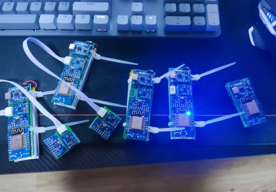

What is the difference between KitKat and other slimevrs?
I designed all the places that need to be welded on the same side, so that even novices with no welding skills can easily get started.
Kitkat uses the solution of MPU6500/6050+QMC5883L. Because of the addition of magnetometer, it is greatly improved compared to only using 6500/6050.
The kitkat is sized to fit a 903090 battery perfectly, and because of that, it might not even need a case..
Modules/components needed for this tracker
  • D1 MINI
  • MPU6500 (6050 is also OK, the spacing may need to be adjusted)
  • QMC5883L (silk screen HA5883)
  • 1N5817 diode×2
  • 180K resistor
  • TP4056 charging module
  • 12D19 switch
  • 3.7v battery (I used 903090)
  • PH2.00 socket (used to connect the auxiliary sensor, you don’t need it if you don’t need it)
  • PH2.00 connecting cable (used to connect the auxiliary sensor, you don’t need it if you don’t need it)
Things to note:
  1. Be sure to test whether the module is normal before welding. Yes, there are bad parts in this thing. It is recommended to make a test board first (soldering the female header at the sensor position), so that even if it is broken, you only need to unplug it and replace it with another one to continue testing. That’s it, test it and if there is no problem, then solder it to the board.
  2. QMC5883L chooses silk screen printing HA5883
  3. QMC5883L needs to be tested for more than 5 minutes to see if it is normal, because I have encountered problems with the axis changing to reverse and steering delays when using it.
  4. Some merchants may ship MPU6800 (0x74) as MPU6500, which cannot be used. Please note that the address of MPU6500 is 0X70 and the address of MPU6050 is 0X68
  5. Don’t buy expensive batteries
The difference between the three PCBs:
From left to right are the kitkat host, cookie auxiliary tracker, sandwich auxiliary tracker, and sandwich adapter board (you can attach a magnetometer to the previously made 6500/6050 tracker. You can also fly the line directly without this pcb. Details Reference schematic
firmware
These are the versions I modified
0.2.2 Normal version firmware
0.2.2 Firmware with magnetometer filter
The firmware can be downloaded from the QMC branch of SlimeVR . After downloading, you need to modify the axial direction in three places.
mpu9250sensor.cpp under src/sensors , modify lines 253~2455 , replace x with y , y with z , and remove the negative sign in front of z
② Change lines 357~359 like this too
③Change No. 269~271 to x, z, y
Then the board type and mpu in defines.h are changed to this
