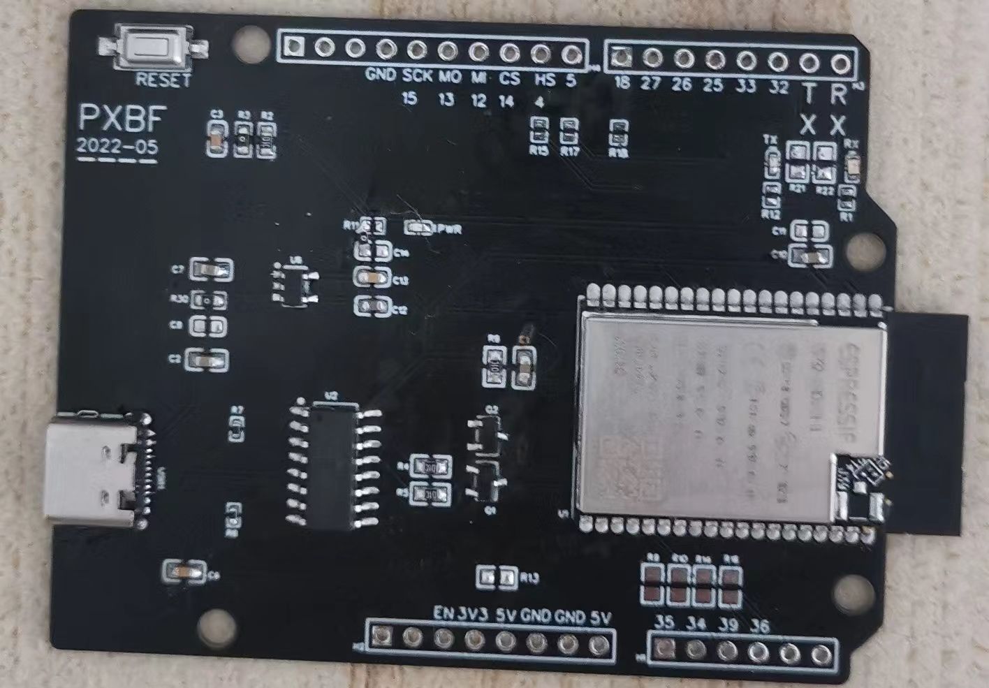

Arduino board based on ESP32, using Type-C interface for power supply and programming
The hardware interface part has slight compatibility changes, mainly used to connect to the STM32F469-Discovery development board. ESP32 burns Espressif's official AT instruction set image and is used as a WIFI network card.
This development board can be used alone as an ESP32 development board, or it can be burned into the ESP32-AT instruction set image and used as a wifi network card.
