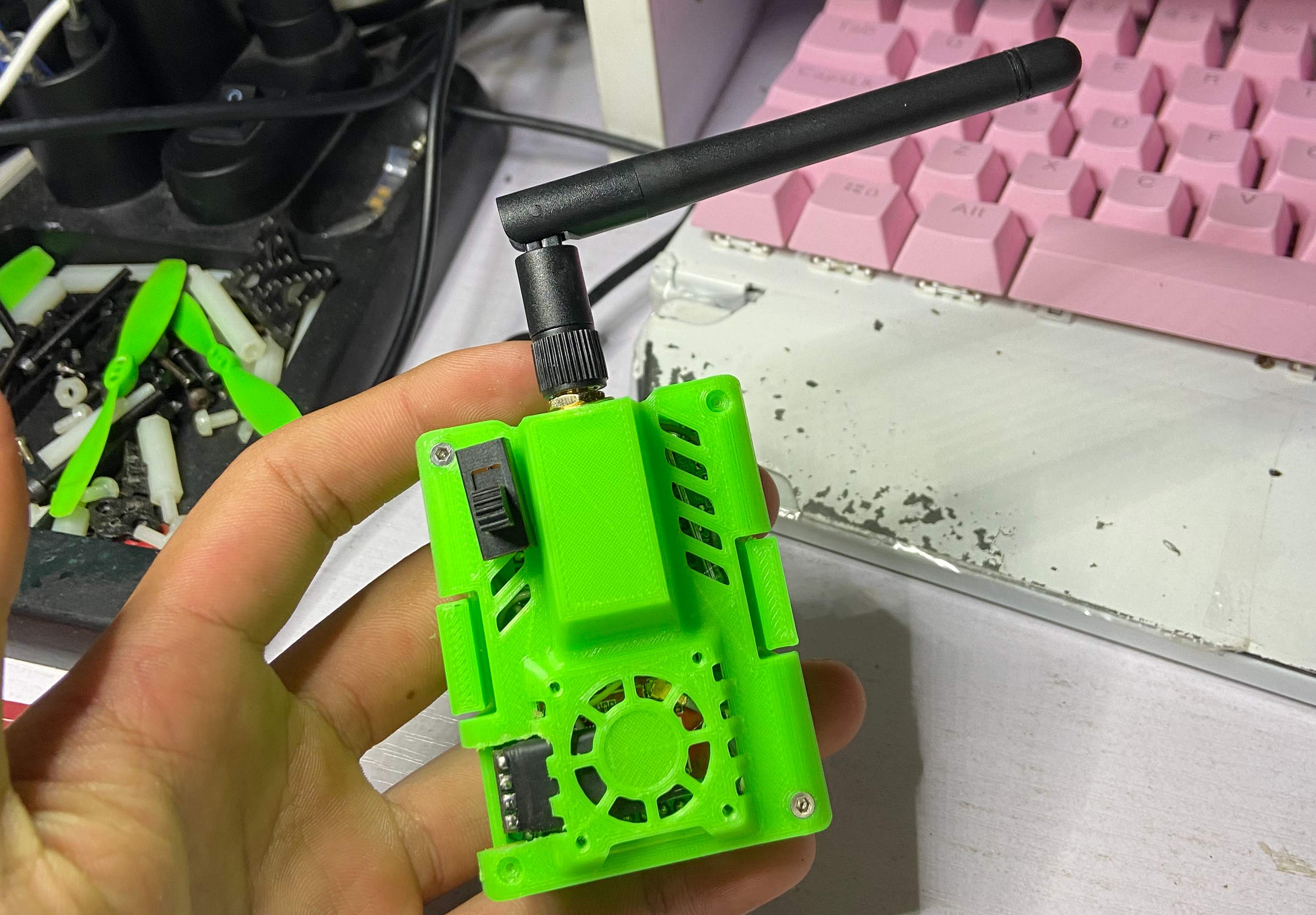

The 2.4G part has been assembled. Cut it out and stack it up through pin headers. Cut out the E28 and ESP32 onboard antennas from the upper 2.4G part.
Part 2.4 uses internal antenna, part 915 uses external antenna.
The current version has been verified to have 2 line problems, which require flying lines for normal use. They have been corrected.
Waiting for the second board verification (the current project file is a corrected version)
