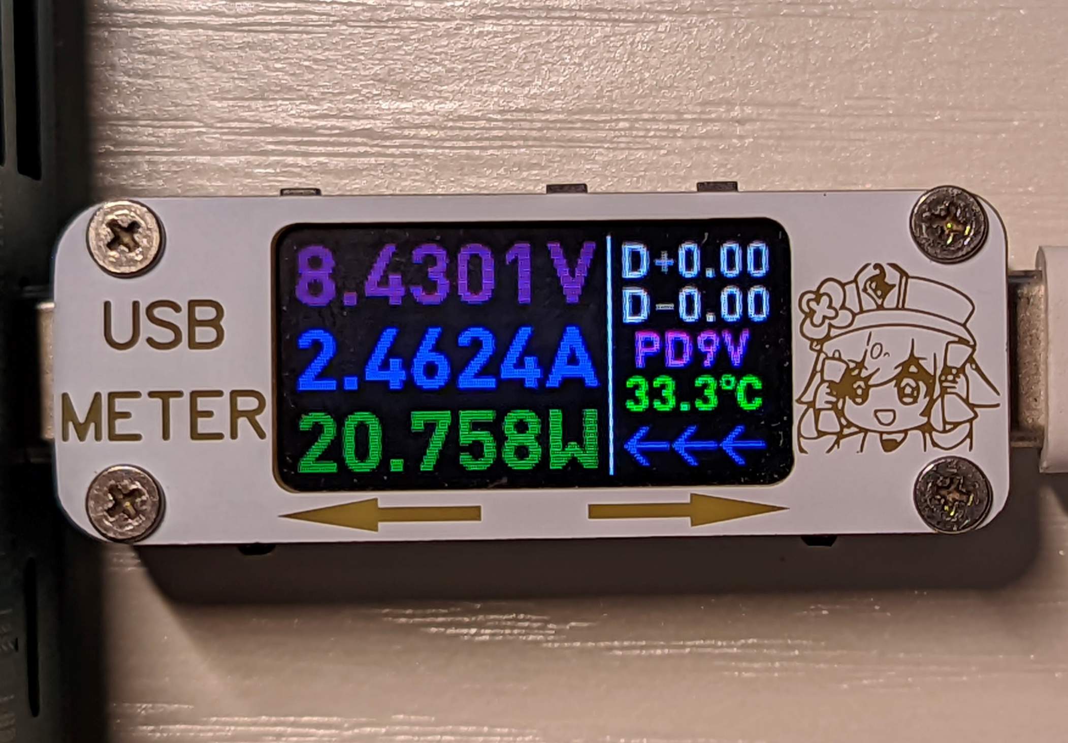

USB power meter based on ESP32-PICO-D4, the display uses a 0.96TFT color screen, the voltage and current sampling part uses the INA226/INA231 solution, PD monitoring and deception uses the FUSB302PD physical layer chip, QC monitoring and deception uses the ADC and DAC of ESP32, in theory It also supports other A-port protocols, but there is no other A-port communication device on hand to collect the communication process of the protocol.
Basic functions of this watch:
1. Basic bidirectional voltage and current monitoring, simple self-consumption zero calibration, real-time monitoring of D+ D- voltage, real-time charging protocol (only supports PDQCDCP for now).
2. Voltage deception: full voltage deception of QCQC3, FIXPPS deception of PD3.0.
3. Software coulomb meter can calculate the amount of electricity charged. The charging voltage, current and actual load time can be calculated.
4. A variety of data records, which can monitor the board temperature, the maximum and minimum voltage, current, and power values ​​during the charging process, and the average voltage, current, and power values.
5. With offline data recording, you can choose whether to inherit the last data and continue recording to prevent accidental power outage data loss. At the same time, it can also record and display 5 groups of recently recorded data. The recorded content is the average value of voltage, current, power, and load. Time, charging mAh and mWh.
6. This watch has almost complete PD logic packet capture function and common PD data packet analysis function. It can monitor the PDO of the charger, display the currently applied RDO in real time, record and display every data packet in the communication process, and Parse common data packets.

Hardware and soldering tutorials
The main control adopts ESP32-PICO-D4, with simplified peripherals and smaller board size. It has WIFI and Bluetooth functions for later development of the host computer.
MP2451/MP2456 can be used for DCDC, and INA226 (maximum voltage 36V)/INA231 (maximum voltage 28V) can be used for current monitoring chips.
PD monitoring and deception uses FUSB302 physical layer chip.
A-port monitoring and deception directly use the ADC and DAC of ESP32. Currently, the A-port protocol only supports QC/QC3. In theory, other A-port protocols are also supported, but there are no other A-port communication devices on hand to collect the communication process of the protocol.
The screen uses a 0.96 TFT color screen and is driven by ST7735S.
