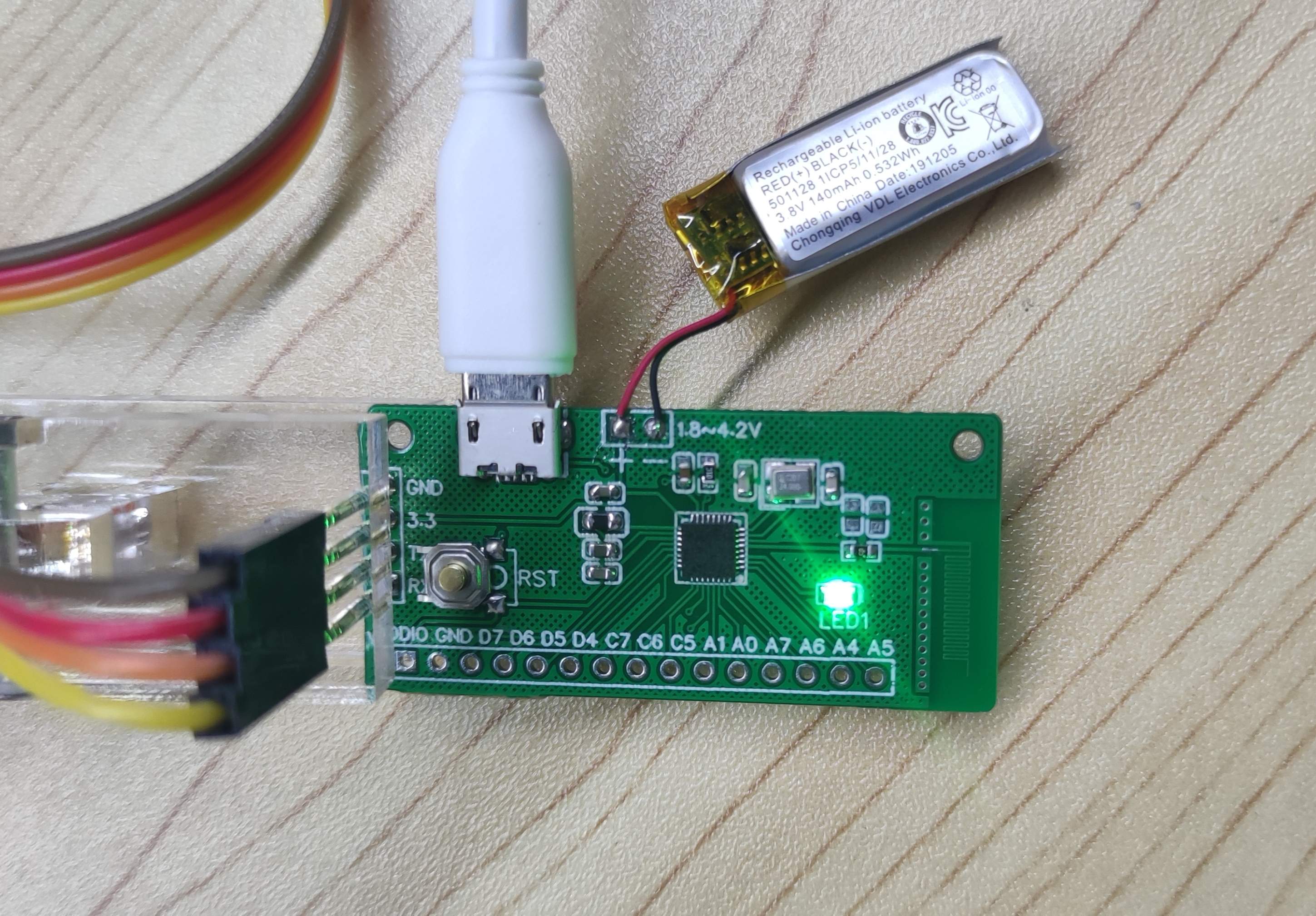

Bluetooth fr8012HAQ minimal system
A minimal system with a domestic Bluetooth chip.
From Shanghai Furuikun Microelectronics.
The main controller for the Bluetooth price tag on Xianyu is 30 yuan, and Taobao sells it for 3.5 yuan a piece with free shipping.
Built-in 512k flash 48K ram LDO and lithium battery charging M3 core Bluetooth chip, can be developed with gcc or keil
Features:
   Bluetooth 5.1 certification
   Higher transmit power and sensitivity
   Built-in power management module PMU (maximum charging current 200mA)
   16-Bit Audio Codec (DAC SNR 96dB, ADC SNR 84dB)
   Provide support for Apple Homekit development kit
   Minimalist peripheral circuit and low-cost BOM
