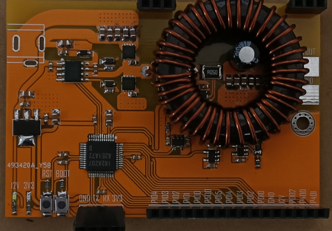

A low-power (24W) buck converter with adjustable output voltage and current based on the Renesas R7FA2E1A72DFL controller.
This design is a low-power buck converter (24W) with controllable voltage and current. It is
designed using the Renesas R7FA2E1A72DFL controller and uses Four peripheral control schemes: PWM, ADC, SPI, and GPIO
: ADC sampling of the output current and output voltage, and dual-loop PI control. The voltage loop is the outer loop and the current loop is the inner loop.
Interactive panel: imitates the Unilever adjustable power supply. Design, two rotary encoders adjust the output voltage and output current respectively, three of the four mute buttons are used to quickly switch output parameters, one is used for output enable, and an output enable indicator light.

Figure 4 Buck converter front
Figure 5 Buck converter back

Other random thoughts:
This design uses a 12V power adapter for power supply. The power supply for the gate driver is taken directly from the input voltage. If you need to increase the input voltage level, please provide 12V power supply for the gate driver.
The voltage sampling circuit and current sampling circuit of this design are preset with active RC filter circuits. If the ADC sampling waveform has many burrs, a low-pass filter of a certain frequency can be added, usually 16kHz, with a resistance of 10kΩ and a capacitance of 10kΩ. 1nF.
This design uses MOS tubes instead of rectifier diodes on the low side, and sets a reasonable PWM dead time to achieve ZVS turn-on of the lower tube and improve efficiency.
In this design, the input filter capacitor is placed close to the drain of the MOS tube to reduce parasitic inductance.
In this design, the filter inductor is placed close to the midpoint of the half-bridge to reduce the copper area of ​​the power node and reduce the antenna effect.
In this design, the digital ground and power ground are isolated, and only a single point connection is made for gate driving and signal sampling.
