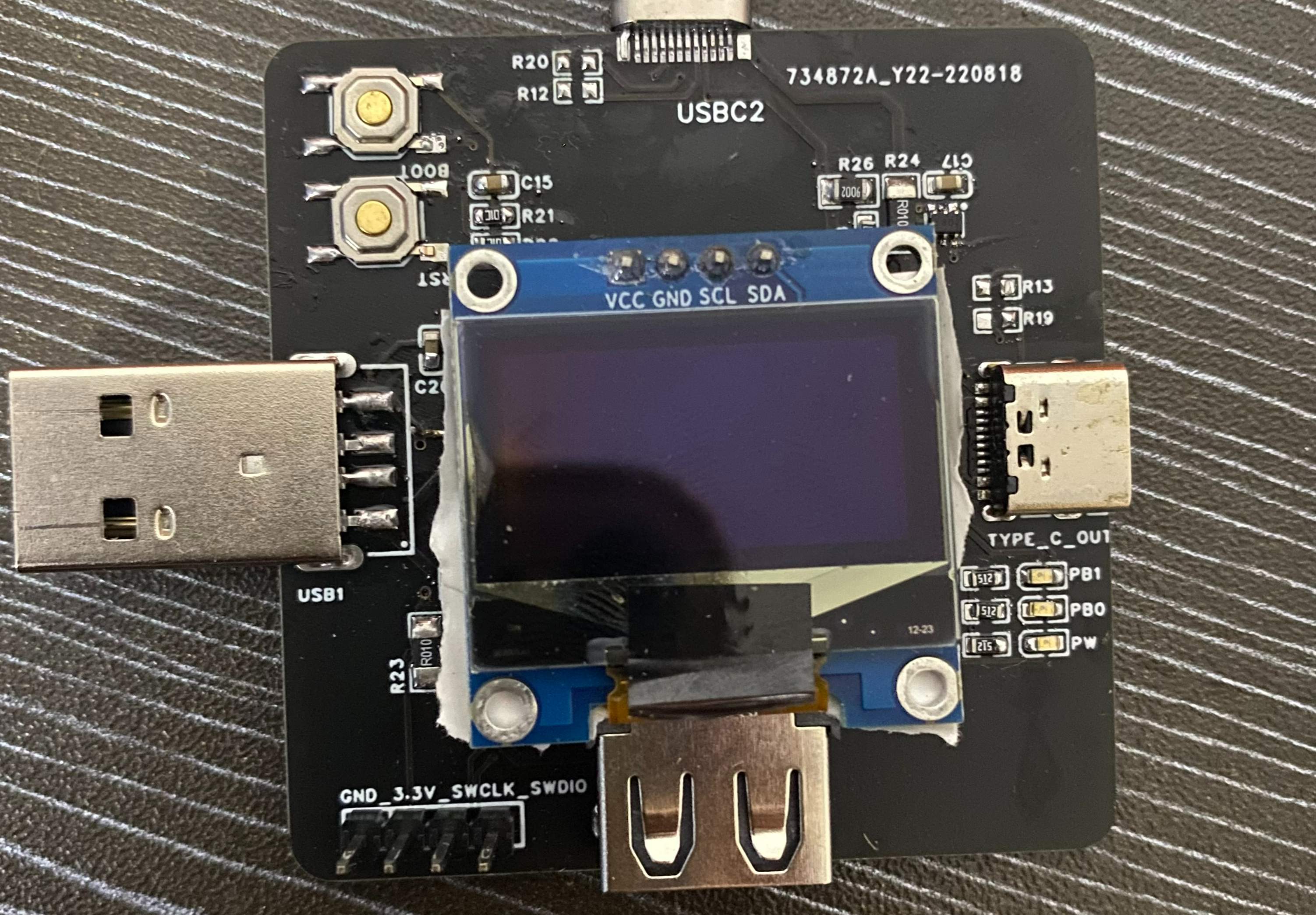

1. Check the output voltage, current and power of the USB port
2. Support the input and output of the TYPE_C interface, and check the current, voltage and power of the interface (due to design defects, this function has not been fully realized!)

uses two INA199A1DCKRs for current sampling of USB and TYPE_C interfaces, and a 90K and a 10K resistor are used for voltage sampling. The power supply uses UMW78L05, and the chip is naturally the N32G430C8L7 of National Technology. Secondly, there is a design defect 2vDBKNJyPxoJW6jtetJRSx0PFiDe4KDIJNMXxfOV.pngthat L3 and L4 must be replaced with two diodes with the lowest voltage drop, because this place is connected, resulting in voltage at the USB port and the type-c port when the voltage is sampled. The reason why the diode with the lowest voltage drop is because the voltage drop is low, the mcu can work normally, but the screen is dark. If you don't mind the trouble, you can also directly replace this route with a switch that can switch the circuit.
BkGAoY9TvQjl5KsAr44Nu1AvPPuhGqide4l5GzaH.pngThis is when it is working normally.
