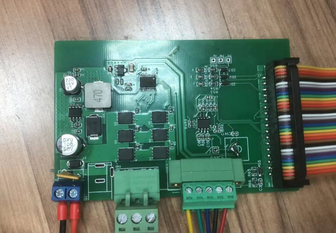

Function demonstration video of actual proofing verification: https://www.bilibili.com/video/bv1KB4y1X7nV Compared with the open source version, the mos and mos drivers have been changed. The LI of the mos driver is positive logic, which is different from the original one. In the routine, just change RESET to SET in the relevant part, and SET to RESET. The basic functions of the power board and small motherboard have been successfully reproduced.
