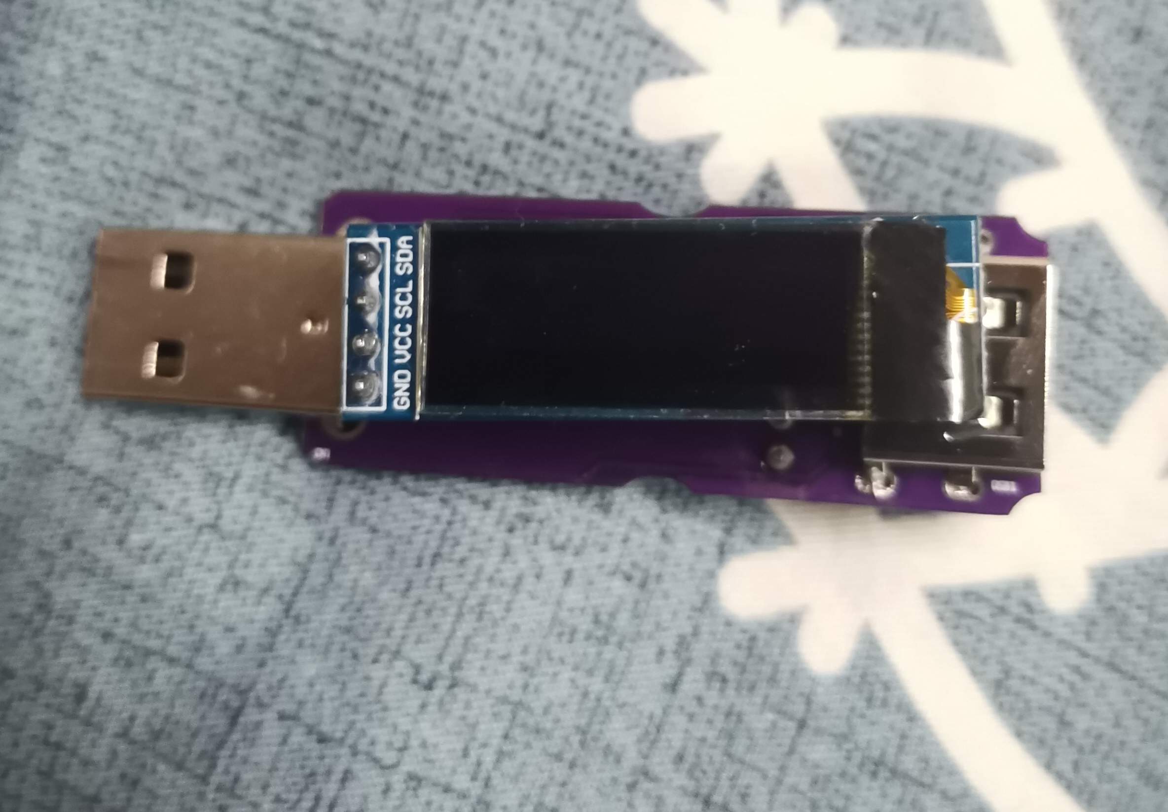

* 1. Project function introduction
It can measure the voltage, current and power during operation.
* 2. Project features
0.91-inch OLED screen, with clear and compact display effect;
PCB board is adapted to the public version housing;
low-resistance sampling resistor is used to prevent excessive internal resistance from affecting the USB power supply efficiency;
Maximum voltage measurement support: 6V
Maximum measurement current: 2.8A
Support power display

The USB input uses a Type-A male connector, which inputs a 5V voltage. This interface supports a maximum output of 3A. If it is larger, it will get a little hot. It is recommended not to exceed 3A of current. If you need to use a larger current, please replace the Type-A male connector.
picture.pngThe USB output uses a 4P sinker female socket. In order to adapt to the public version housing, the maximum rated current of this female socket is 1.5A. The actual measurement is 2.5A, but it is not suitable for long-term operation at this current. If you need to use a larger current, please replace it yourself.

picture.pngOLED display module
oled display uses iic communication, it costs more than 12 yuan on Taobao, the quality is very good, very good
