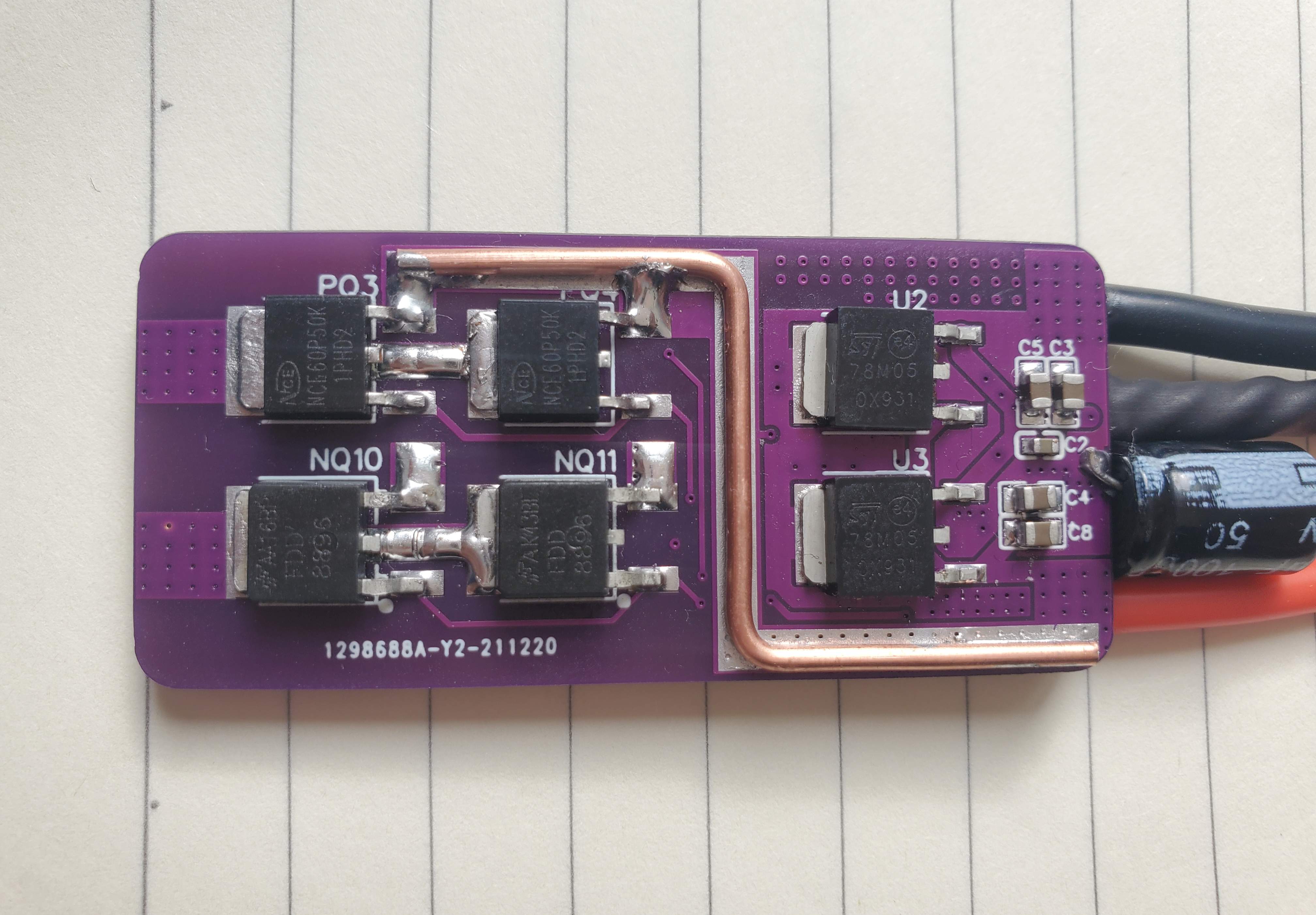

Link to the original version of Loli: http://www.moz8.com/thread-173326-1-1.html
1. Wide voltage input 1s~6s, bec output 1A, heating is just right
2. Parallel mos management theoretical current 60A but no Tried 40A and tested. Need to add a heat sink. This is
the first open source. If you have any questions, please leave a message
here to collect the PN version of the firmware with brake. Thank you.
