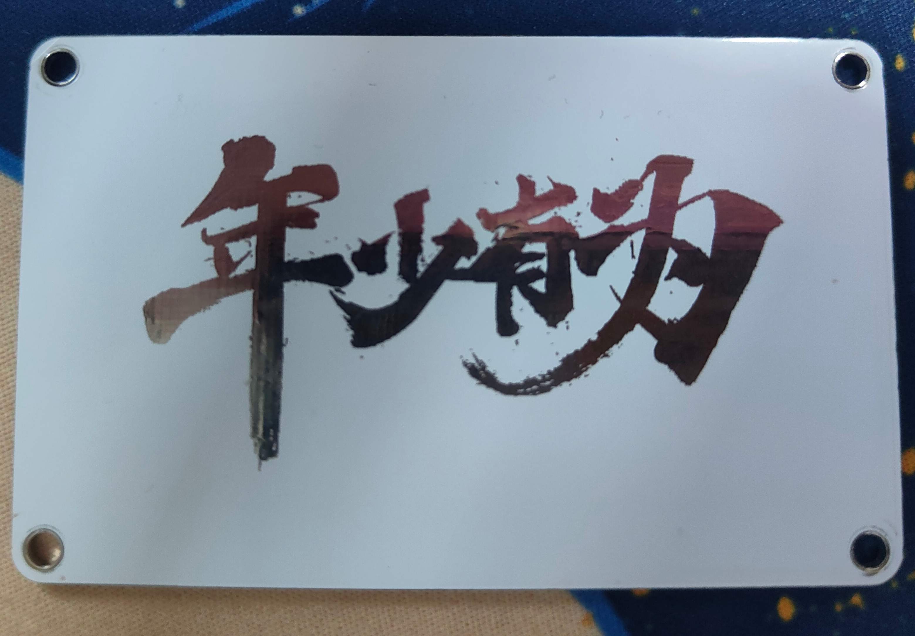

The PCB picture picture this time is used to decorate the USB docking station. The picture below is the finished product.
The picture below is a 3D preview of the PCB:
The actual picture is as follows (the proof is white):
Principle: Copper is applied to both the front and back sides (without copper, the desired effect will not be achieved), and the picture is placed on the Top Solider and Bottom Solider layers , you can realize the display of pictures (text).

Note: If you want to place the picture on the Bottom Solider layer, you need to use PS to mirror the picture left and right.
