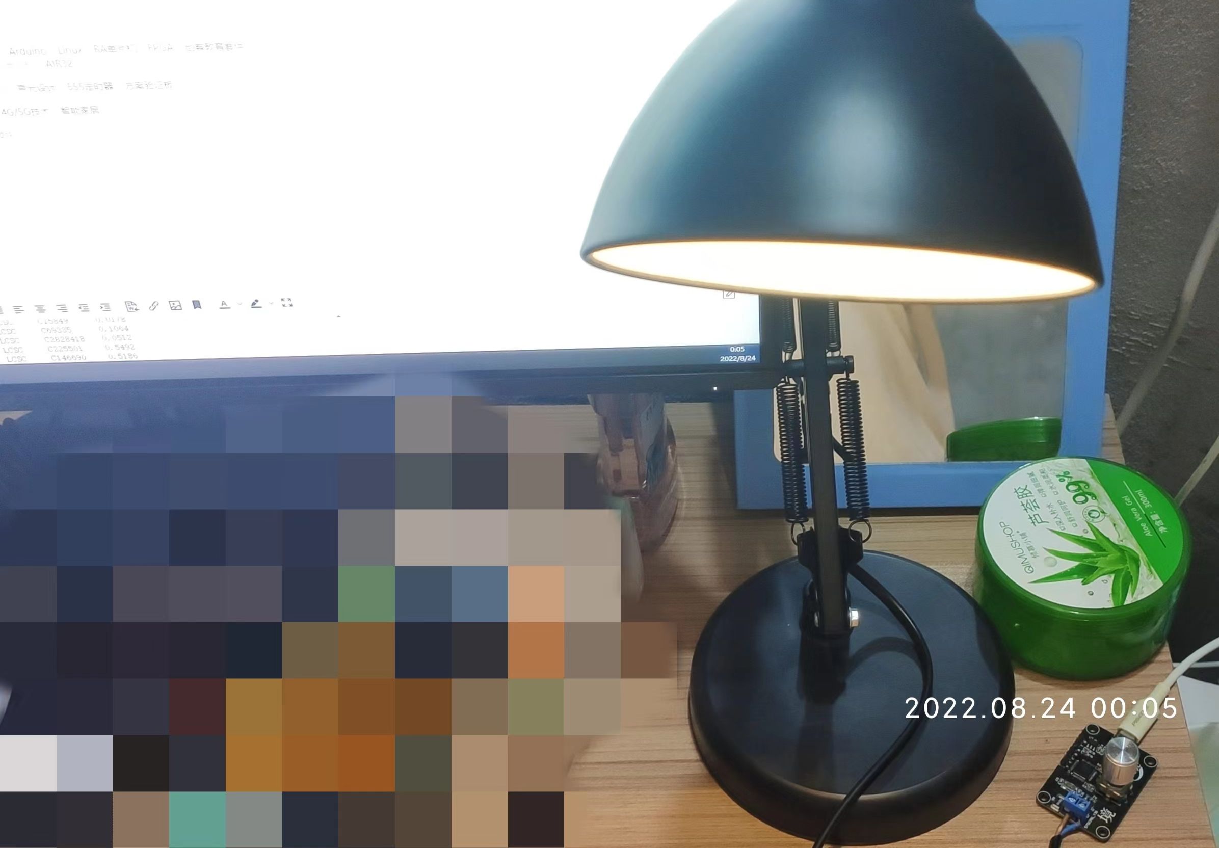

* 1. Project function introduction
This design is a smart desk lamp based on N32G430C8L7. The functions include 1. Switching the desk lamp, 2. Adjusting the light brightness.
The brightness adjustment part uses the current feedback method to make the dimming more layered. This design has a voltage acquisition circuit, which calculates the power of the desk lamp through the collected voltage and current to prevent the power of the desk lamp from exceeding the preset value and ensure the life of the desk lamp.

* 8, demonstrate your project and record it as a video upload
参考设计图片
