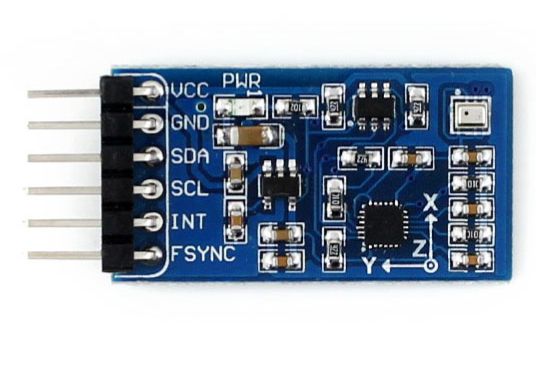

interface description
pin number
identification
description
VCC
3.3V or 5V power supply
GND
power ground
SDA
I2C data line
SCL
I2C clock line
INT
MPU9250 digital interrupt output
FSYNC
MPU9250 frame synchronization signal
