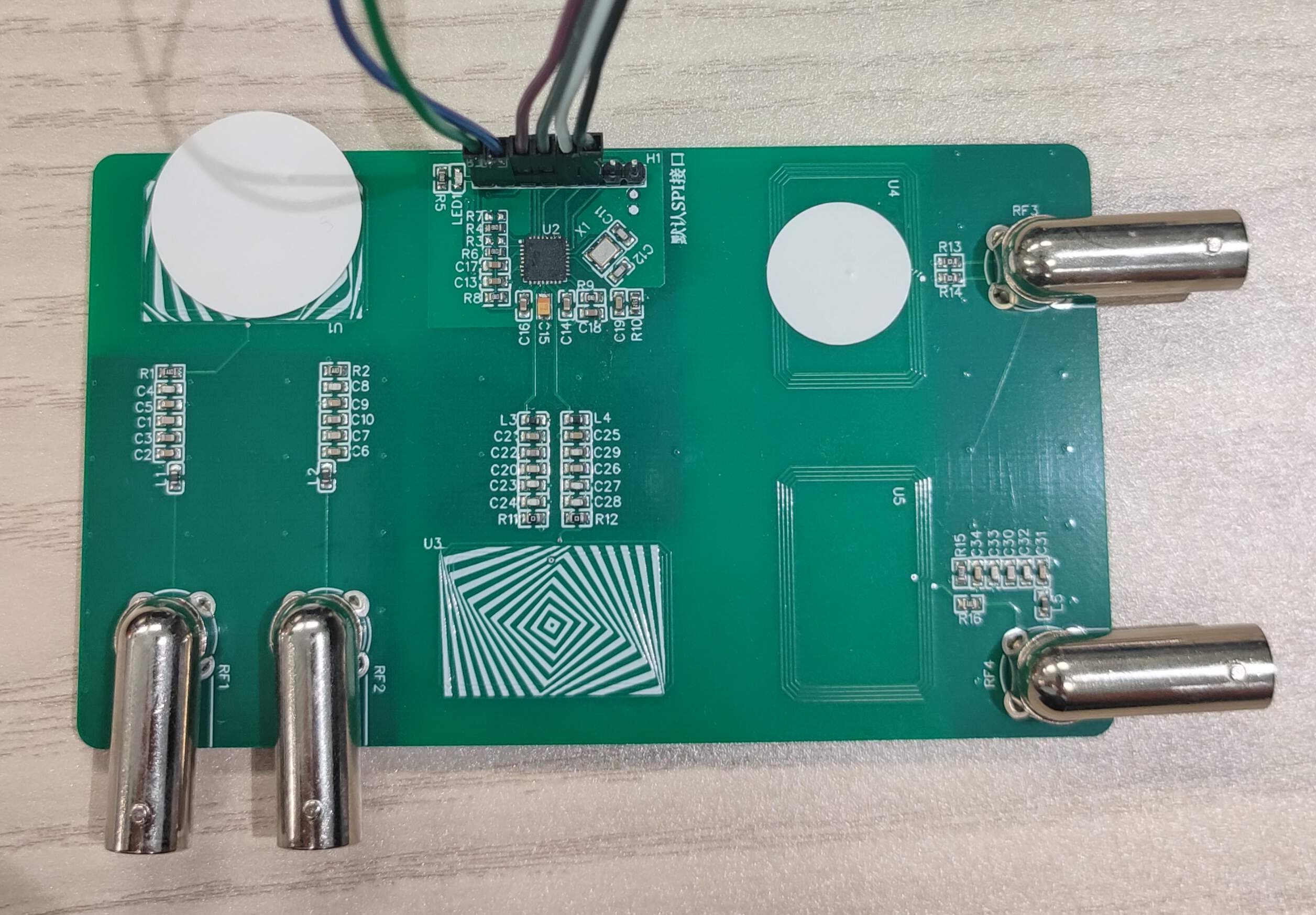

MFRC522_NFC card swiping circuit_learning board
NFC communication verification board based on MFRC522, SPI interface, fully compatible with Arduino's MFRC522 library.
Because my project requires a very small NFC antenna, 30*20mm. So we need to redraw a PCB NFC antenna. But I was worried about impedance matching and domestic chip compatibility issues, so I made a verification board first. By the way, learn how to tune the 13.56MHz antenna.
There are four areas on the board, namely
1. Matching circuit without rc522 chip, including filtering, matching, and NFC antenna.
2. Complete circuit with RC522, the default is SPI interface, which can be directly connected to Arduino, and the card can be swiped in 3 minutes.
3. A single NFC antenna is used to easily connect the equivalent L, R, C, etc. of the VNA test antenna.
4. The NFC antenna plus matching circuit is only half of the antenna to facilitate impedance debugging.
It has been sampled and verified and is available. But please note that I am not making boards at Jialichuang, and the impedance matching parameters may need to be adjusted. (It’s not a big problem if you don’t adjust it. At most, the sensing distance is slightly shorter.)
Test conditions: Arduino platform, Dupont line link module SPI interface, 13mm diameter NFC tag (high temperature resistant tag, actual effective diameter is estimated to be 10mm)
test results: The card reading is normal, and the effective reading distance is about 20mm (the antenna and tag are both very small, and the distance required by the project cannot be large).
In addition, Arduino's MFRC522 library also supports reading the tag content in turn when two NFC tags overlap. (I asked several people who sell nfc modules online and they all said no. This is the biggest reason for making this module).
The remaining items and pictures are to be added.
