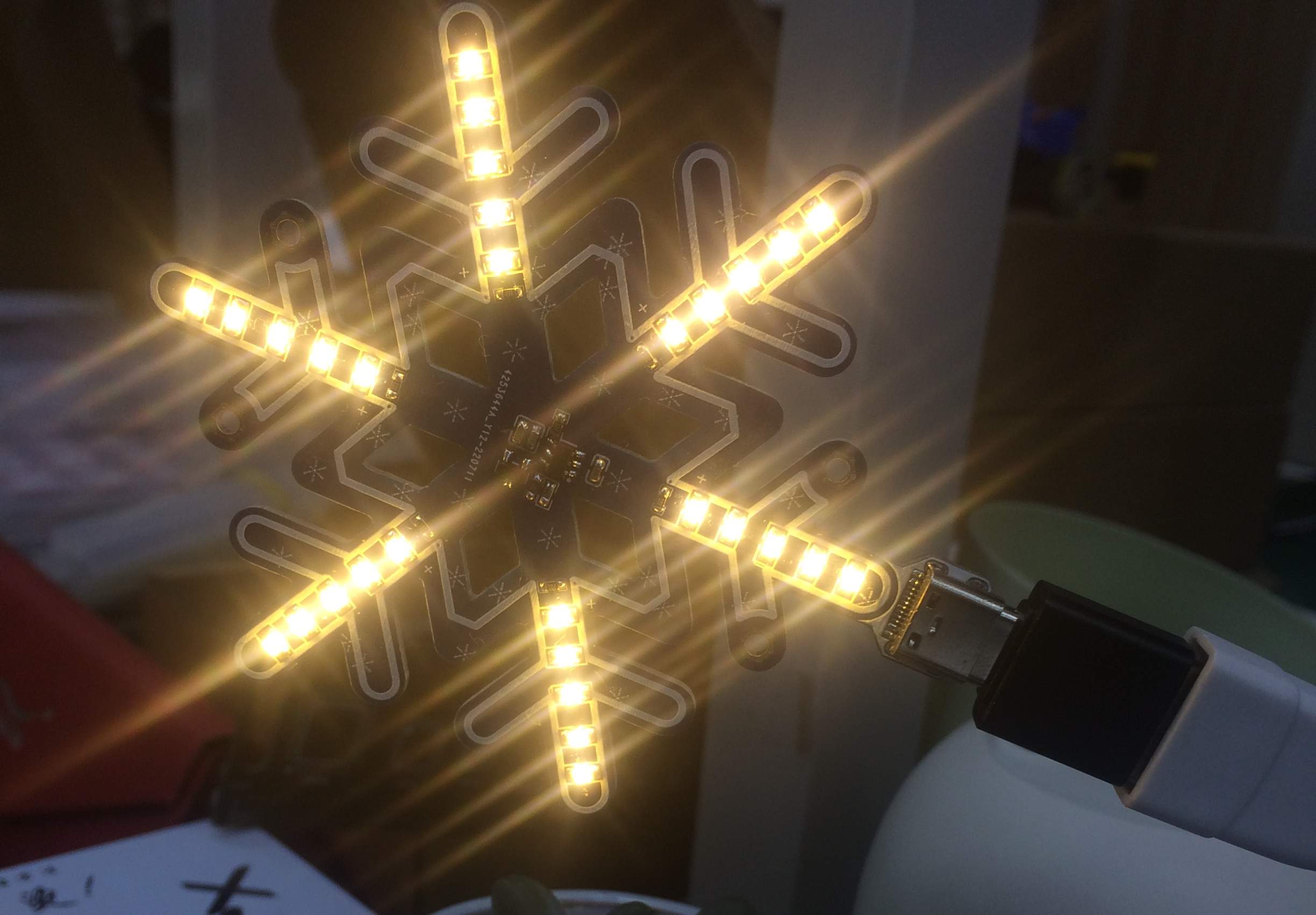

Touch stepless dimming snowflake lamp
Original version: The graphics adopt the graphics of mondraker boss.
Modified Version: Lots of Advantages
Reasons for Modification: After seeing Mondraker’s project, I couldn’t wait to build the board and buy components. When I bought the components, I found that the ceramic filament was really expensive (not to refute Mondraker’s project). 5 cents each, and the chip SGL8022W used by the boss is not available in Lichuang Mall (the majority of white* parties are directly unhappy), Taobao is still relatively expensive, and the tantalum capacitor costs about 10 yuan, although it is added It can still light up without adding tantalum capacitor. . . But the most important thing is that after I soldered it, I tried it with great expectations. Suddenly the tantalum capacitor started to smoke, which scared me to death! ! ! , (I rarely use tantalum capacitors, I am a novice) after a long experience. . . . It's finally fine. I put it in my pocket. Unexpectedly, the light broke. The frequency of the break was very fast. It costs 5 cents and 50 cents. Moreover, as a pendant, it is easier to break the light. After my collapse, I suddenly sprouted I thought of changing it. So it was born at zero cost! ! !
Advantages: Compared with the big one, this one uses ordinary LED lights, and the light will not break even if you sit on your butt. And the most important thing is zero cost (old users know how to make money*, novices are better, just register for 300,000* in Lichuang Mall* and place an order according to the product number below)
Disadvantages: not light-transmissive, many components
Circuit introduction :
The chip uses resistors and capacitors and type-c is the lowest price: () Here is the product number, just search it in Lichuang Mall.
Chip:
Desk lamp stepless dimming chip (C2998018) 0.97 yuan per
capacitor:
10uF (C19702) 0.97 yuan 50 10nF
(C100042) 1.24 yuan 100
100nF is 0.1uF (C282519) 1.12 yuan 100
resistors:
5.1k (C2907114) 0.46 yuan 100
1k (C2907113) 0.45 yuan 100
220R (C103424) 0.57 yuan 100 10
R( C3017781) 0.51 yuan for 100
type-c:
The first model (C165948) is 1.5 yuan each. If you want to make one, choose this one!
The second model (C2927038) costs 3.3 yuan for 10 pieces. If you want to make more, choose this one! !
S8050 transistor (NPN):
NPN (C2891804) 2.6 yuan for 50
LEDs:
see below. . . . Almost all are 2.5 yuan for 50 pieces, and some are 100 pieces.
If you don’t use it for free, the total is only about 10 yuan. In addition, if you buy an extra chip, you can make one more. If you make 10 pieces, it is equivalent to 20 yuan to make 10 pieces, which is two. One yuan apiece, very nice!
Those who know how to make money must buy it for zero yuan! ! !
LED is recommended to use 0805 package
: bright
light: (C965818)
warm white: (C965820)
ice blue: (C84259)
warm yellow: (C84261)
orange: (C84262)
Colors can be freely combined, but please pay attention to the specifications. Different specifications will not light up. You will know this after trying it a few times! Recommended by veterans
with more patches.
Teppanyaki (hand welding is also possible, I did it by hand)
Teppanyaki: fast and convenient, but easy to brown, affecting the appearance.
Manual welding: slow and troublesome, but the welding effect is beautiful.
It is recommended for novices to use manual welding to practice their welding skills and gain a sense of accomplishment.
Of course, if you want to be lazy, you can also buy it directly from Xianyu. If you like originality, you can buy originality ([Xianyu] https://m.tb.cn/h.fyx1mX0?tk=0oXq2JCyGZ3 CZ3457 "Come and pick up the leaks【 Original handmade snowflake lamp, snowflake touch lamp, stepless dimming, gift to friends, pendant can be hung in bags]" Click the link to open it directly) If the quantity is small, it is recommended to come by yourself.
If you like me, you can buy mine ([Xianyu] https://m.tb.cn/h.fxZCtrz?tk=EYGw2Jy00F1 CZ0001 "I released [revised handmade snowflake lamp, snowflake touch lamp, infinite dimming] on Xianyu to give to friends , the pendant can be hung on the bag]" Click the link to open it directly) If the quantity is small, it is recommended to come by yourself.
It is stated that it is not for commercial use and will not be sold in bulk.
         Commercial use is prohibited! ! !
