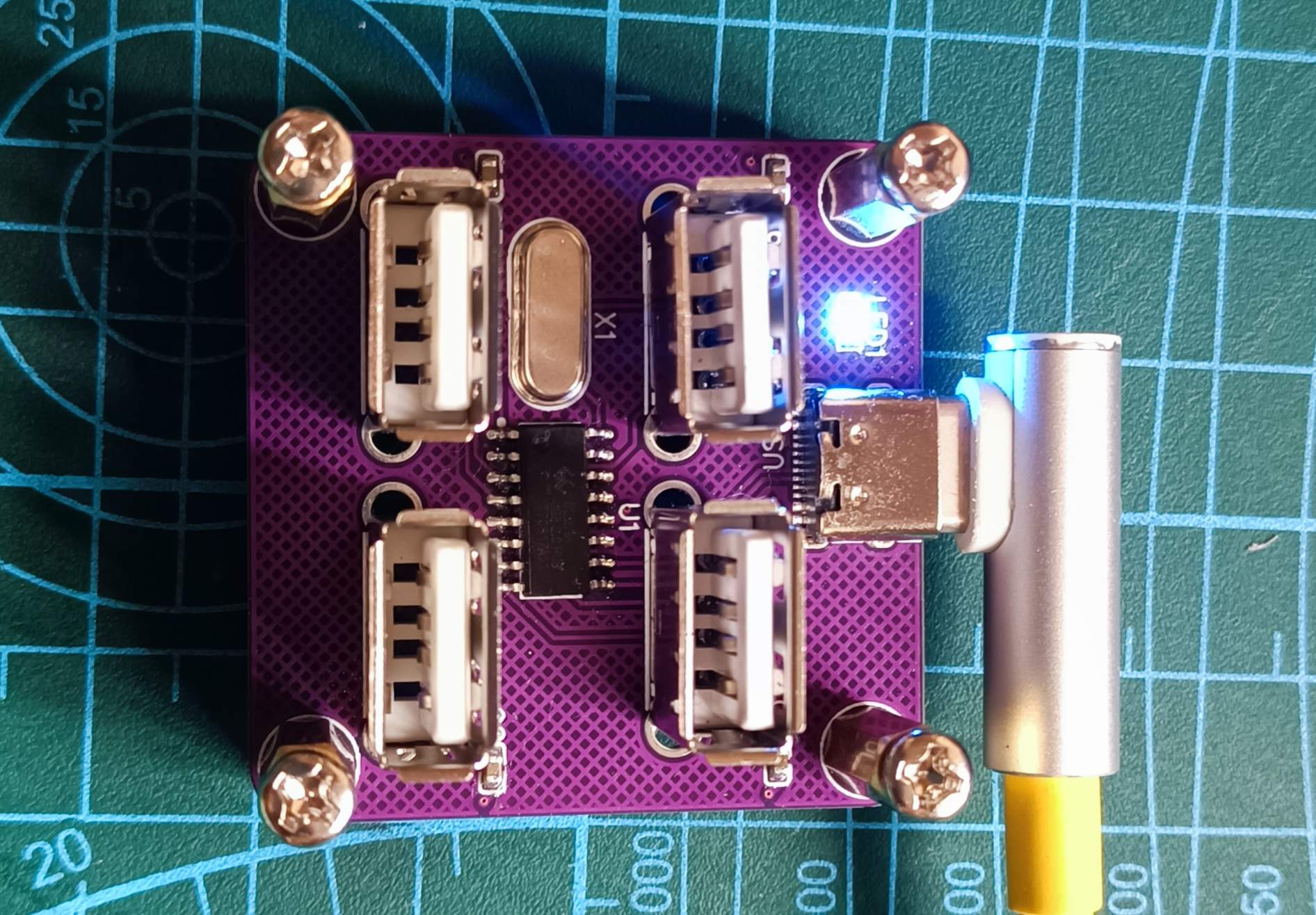

USB-HUB mini splitter based on SL2.1A (verified)
USB-HUB mini four-way splitter based on SL2.1A (verified) There are many open source USB-HUB solutions based on SL2.1A and are more mature than mine, but due to the current open source solutions, they cannot meet the requirements. My personal aesthetic (obsessive-compulsive disorder) led me to have this square mini HUB (the front panel is not available for demonstration at the moment).
During the test, I encountered a metaphysical problem. There is a chance that it will not be recognized by the computer after re-plugging it. There is no extra equipment, so it is impossible to diagnose whether it is a computer problem or a data cable problem.
But it can be used normally when no metaphysical problems occur.
