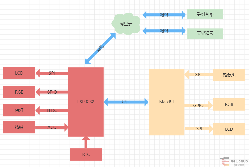

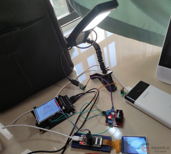

This work is based on ESP32S2 and MaixBit. The LCD display function is implemented on ESP32S2, which can display time, weather information (7-day weather), desk lamp brightness information, network status information, etc. It also implements local control, remote APP control and Tmall Genie voice control functions, which can control the smart desk lamp. Brightness, switch, learning time, delay shutdown, control mode and other functions can be set; the mode control includes manual, automatic, reading and sleeping, which can be switched freely; the camera collects ambient light intensity function is implemented on MaixBit and performs data processing with ESP32S2 through the serial port Interaction; this work also implements the wifi network distribution function, and can use the APP to realize the network distribution of smart network desk lamps.

Blockdiagram
