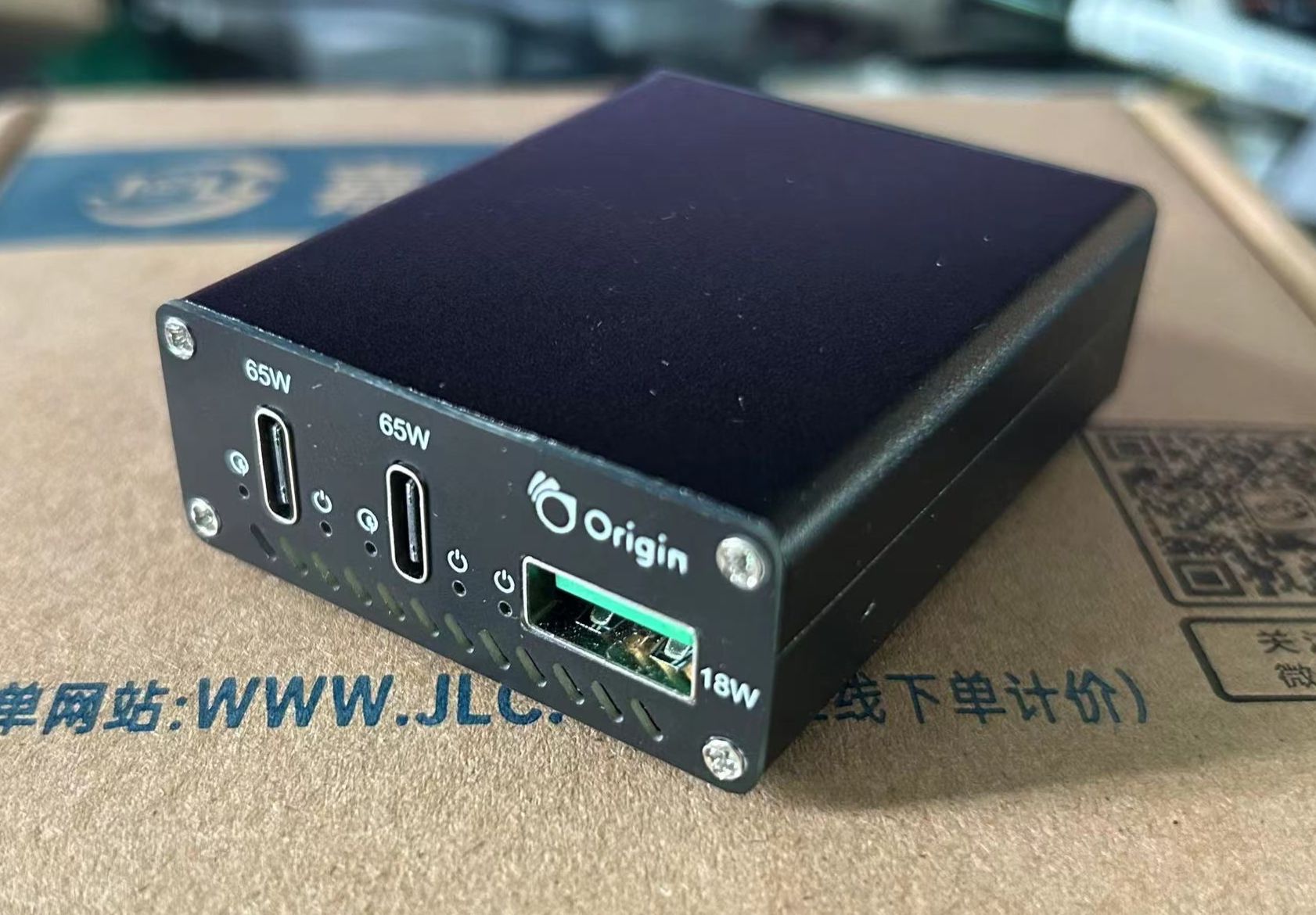

Mini multi-channel vehicle power supply
Mini car power supply has verified the hardware installation and use Q communication group: 754881030
____________________________________________________________________________________________Appearance
specifications:
· All-aluminum shell (including PCB panel)
· 6cm x 2cm x 5cm
· TypeC X2
· TypeA X1Supported
protocols:
·PPS/PD3.0/PD2.0
·QC4+/QC4/QC3.0/QC2.0
·Support AFC/FCP/SCP/high voltage SCP/PE2.0/PE1.1/SFCPProtection
mechanism:
·Soft start/input overvoltage protection/input undervoltage protection/output overcurrent protection/output short circuit protection/over temperature protectionPower
supply parameters:
·Maximum output 3.5A
·Input voltage range 6-35V
·CC/CV mode
·Line loss compensation
BUFF:
·Variable power-on timing
·Variable power
·Variable input voltage
·Variable input interface (self-modification)
PCB:
Actual picture:
