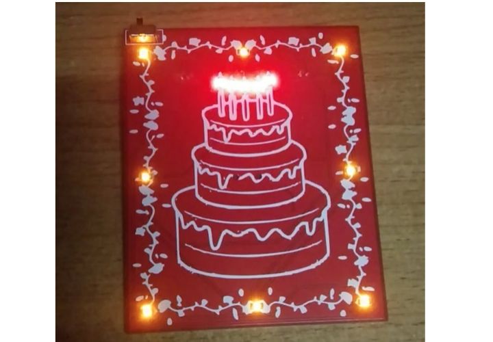

Use a triode multivibrator to achieve the effect of flashing lights.
Note that LEDs should use the same color, otherwise different LED voltage drops will make the circuit asymmetrical and may not be able to maintain oscillation, causing the LED to fail to flicker.
