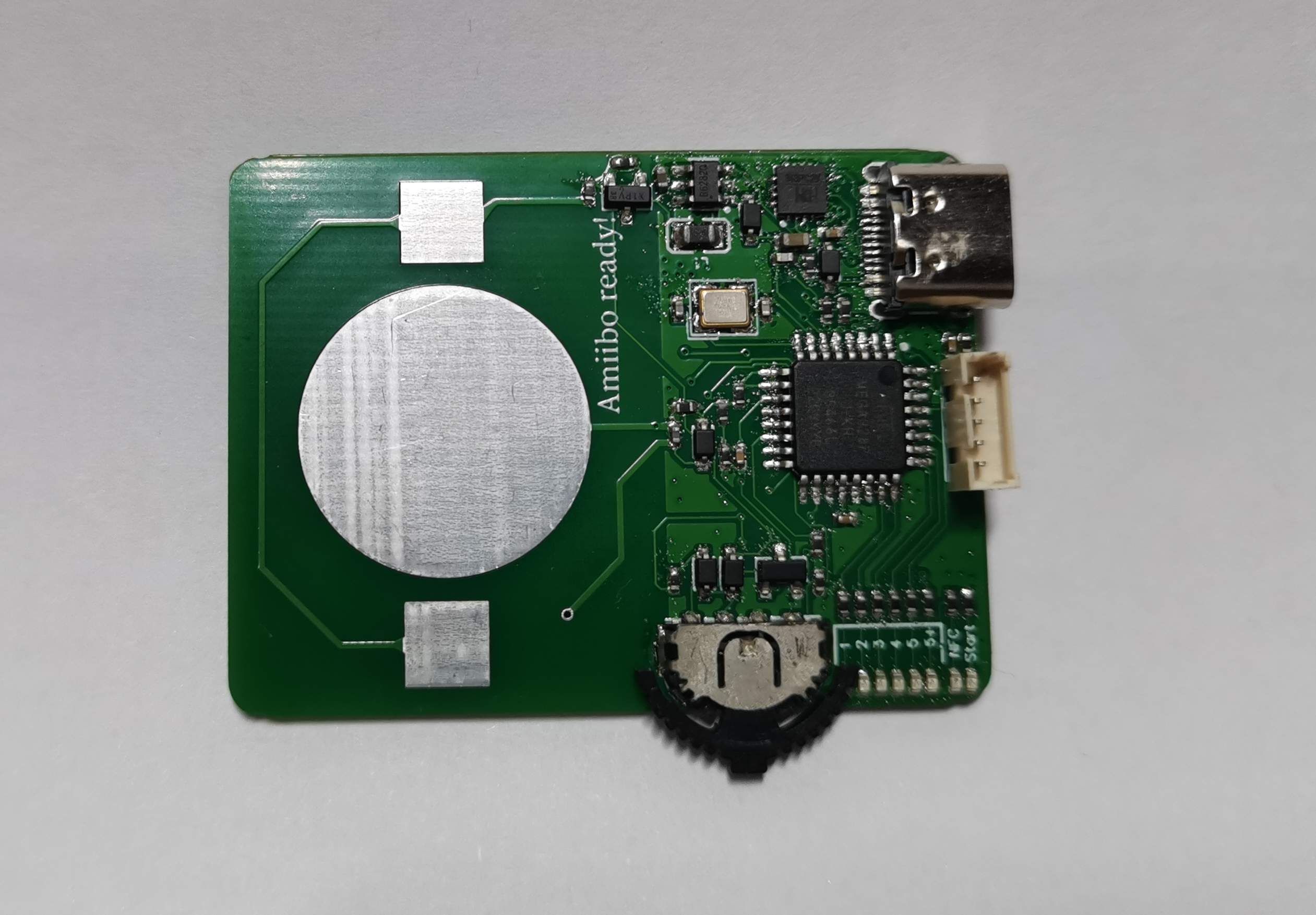

Use ATMEGA328p microcontroller to realize the functions of NTAG215. Power supply mode 1: button battery power supply; mode 2: USB direct power supply.
Note that you need to use USB ISP to burn boot.
The programming software is progisp2.0. First, modify the programming fuse bit to the low value: 0xCE, the high value: 0xDE, the extension bit: 0xFF, and then save it;
then program the optiboot_flash, and only check the chip erase and program FLASH during the process. After burning, uncheck the chip erase and then burn firmware.hex;
refer to the attachment for the bill of materials and firmware, and refer to the production process https://www.bilibili.com/video/BV1SN4y1K7Un/
Finally, thank you to solosky for your guidance!
