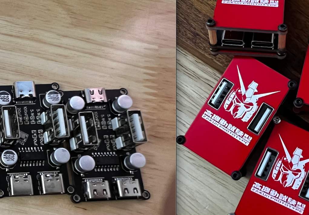

Mini-HUB TypeC input based on SL2.1A
Reference: https://oshwhub.com/dellxh/hub-2a-2c
Only the appearance was changed and the capacitor position was adjusted.
I originally planned to 3D print the shell, but in the spirit of a junker, I used studs, screws and nuts.
It is a plug-in for USB-A and TypeC ports, so a nut is used to raise it so that it can be worn on the keychain (no way? No way? Is there really someone who does this?)
Because everyone has welding problems, I guess the A port needs to be polished.
Screws and nuts M2, studs M2*9mm
