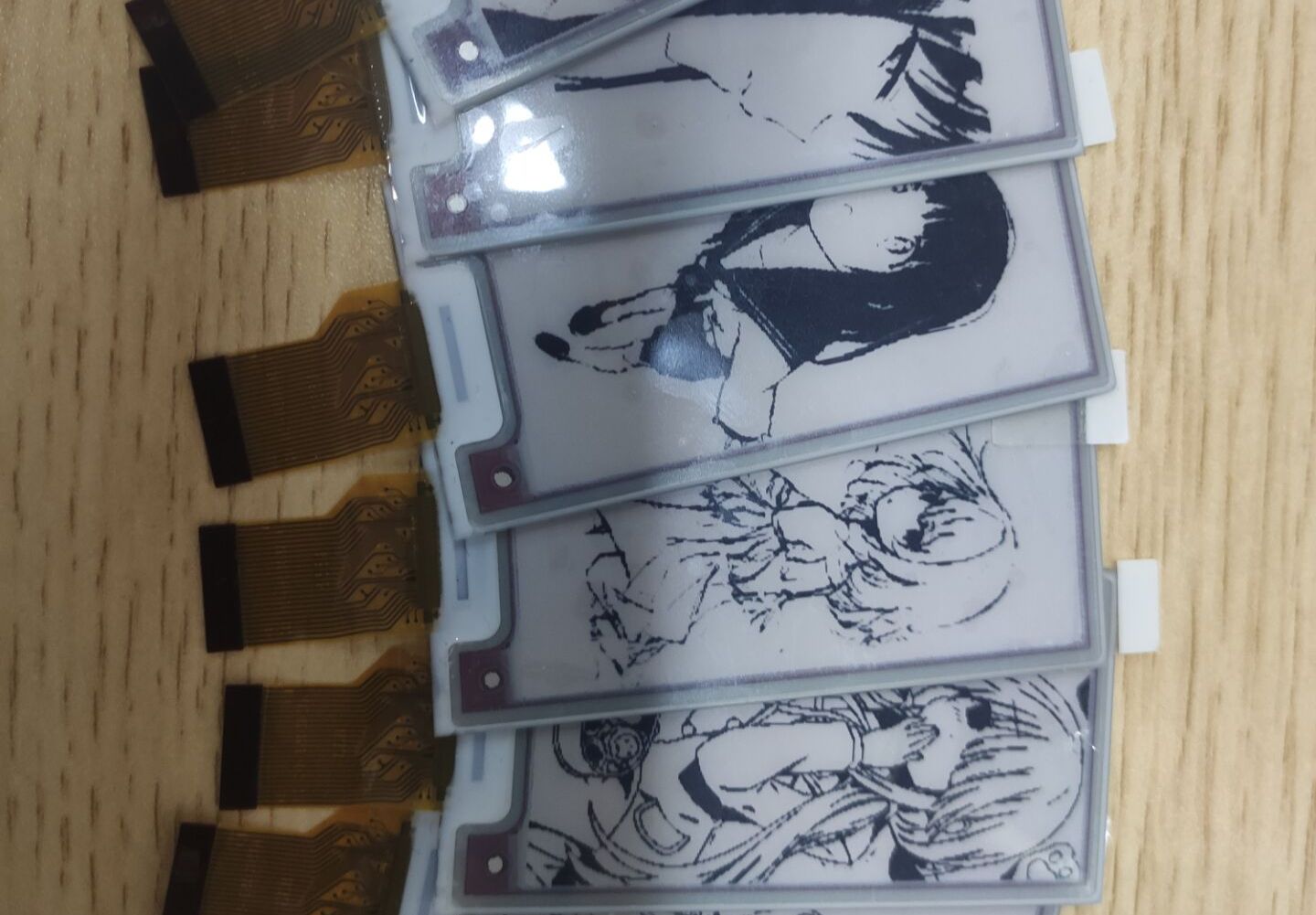

2.66-inch ink screen driver board & driver
The Laowujia 2.66-inch ink screen has a resolution of 152X296, red, black and white. There are about 8 animation pictures in the process, but red is not used in any of them. Personally, I think black and white looks better. There are 8 wires shared. In the schematic diagram, R4 uses a 0.47 ohm resistor, R2 is not soldered, and the FPC socket model uses FPC0.5-24P drawer upper contact.
