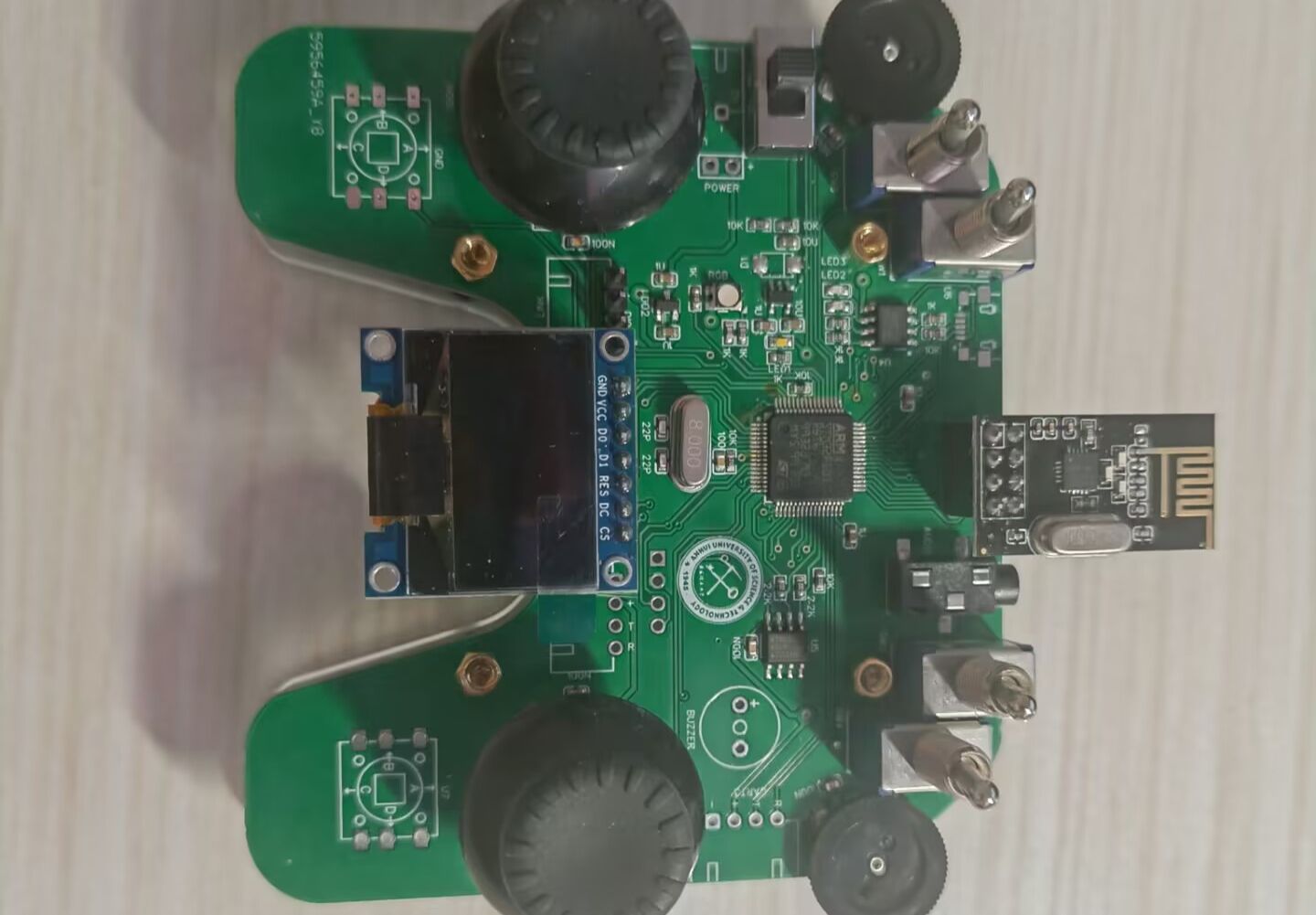

Wireless remote control device based on STM32RBT6
This remote control device is powered by a 3.7V lithium battery. The main control is stm32rbt6. The wireless module is the commonly used NRF24L01, which is usually used for remote control of cars, drones, etc. It has expanded the mpu6050 module, which can be controlled remotely through somatosensory, and two five-way switches. , four toggle switches, two rotary potentiometers, and two omnidirectional potentiometers can meet most remote control scenarios. Remote control information can be displayed through OLED, RGB is added, and a power management chip TP4056 is added, which can provide lithium through the micro port. The battery is charged, the EEPROM is externally expanded, and three serial port channels and a stlink burning channel are introduced.
