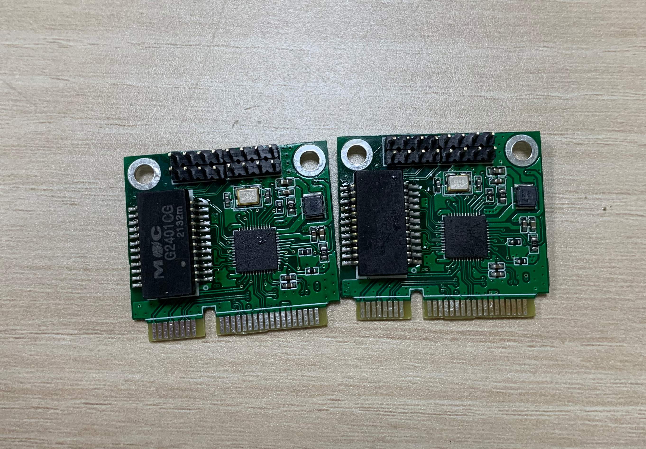

This is a MINI-PCIE to Gigabit network card that has been verified and tested 7*24h (there is a small bug for the time being, but it does not affect use!!!).
Please download the latest VT1.2 version! ! ! When you see that this project is open source, the circuit board has actually reached the VT1.2 version. After experiencing VT1.0 and VT1.1, you can finally eat it with confidence! ! ! (You can open it with a programmer to see my special instructions for optimization and changes in each version)
Chip description:
RTL8111E and RTL8111F are pin-to-pin and have the same functions;
so you can just buy one of the two chips.
The only difference is In terms of price, the new original price is: RTL8111E 15 yuan/piece; RTL8111F 7.5 yuan/piece.
In fact, I don’t know the difference between RTL8111E and RTL8111F? !
RTL8111E (left) RTL8111F (right) Both have been verified and can be used! ! !

Real photo:
My little host! ! (With independent graphics card GT1030)
BUG description:
When you use MINI-PCIE to convert the network card, after you unplug the network cable, the computer still shows that the network cable is still connected. ! It’s a big deal, but it doesn’t affect our normal use.
Description of MAC address conflict:
If you find that the built-in network card and the MINI-PCIE network card you installed are the same, please change the MINI-PCIE network card MAC address! If you conflict and do not modify the MAC address, you will be unable to surf the Internet! !)
