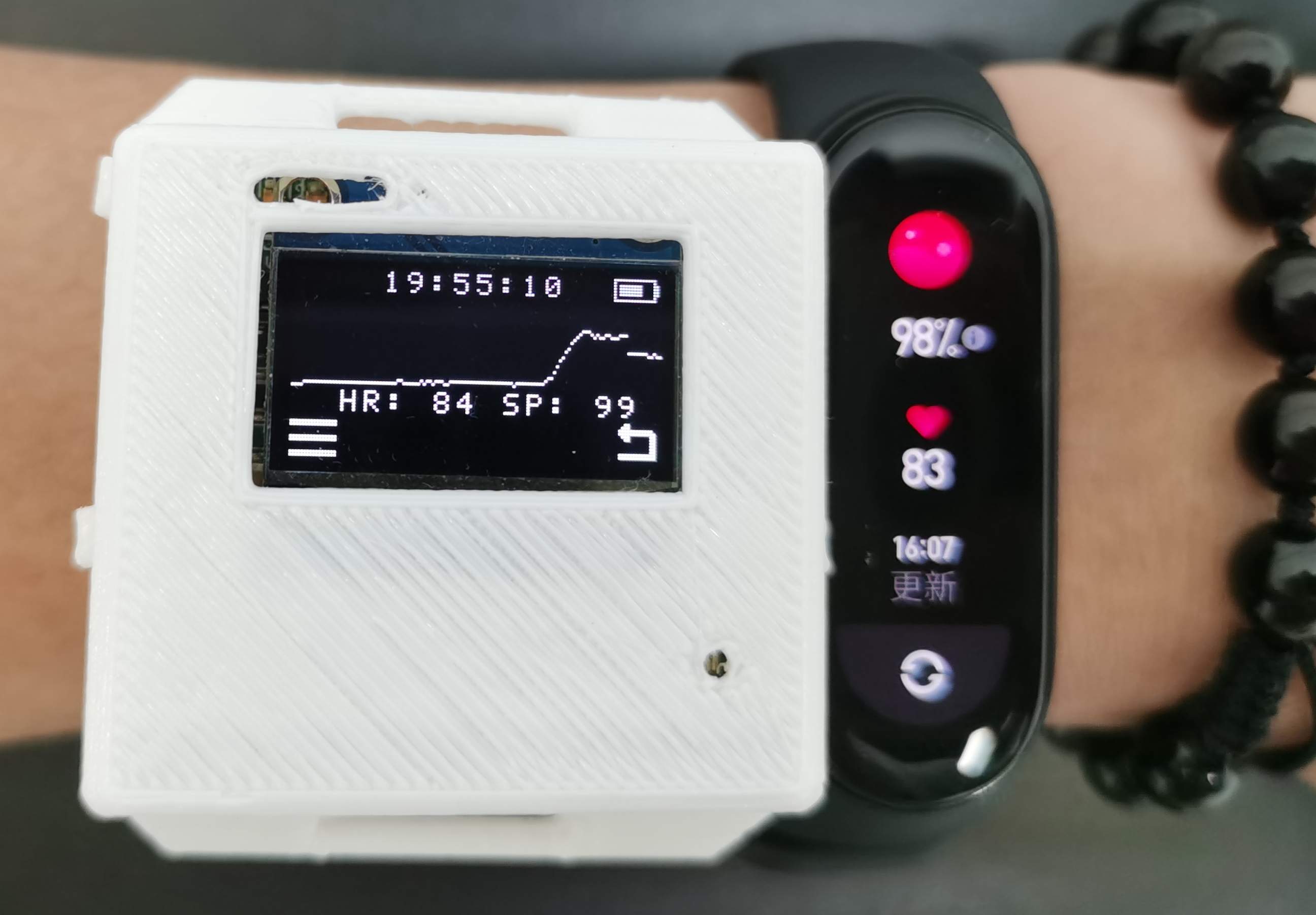

Experimental equipment: STM32F103C8T6+SHT20 temperature and humidity+passive buzzer+MPU6050+0.96-inch OLED (IIC) display+HC-05 Bluetooth module+USB to TTL level tool Experimental purpose: Design and implementation of smart bracelet (graduate Design)
Hardware resources: BEEP: PB8 ADC: PA0 KEY: KEY1 to PA4 KEY2 to PA5 KEY3 to PB4 KEY4 to PB5 SHT20: SCL to PA11 SDA to PA12 MPU6050: SCL to PB6 SDA to PB7 MAX30102: SCL to PB10 SDA to PB11 INT Connect to PB9 OLED: SCL to PA6 SDA to PA7 LED: LED0 to PA8 Serial port 1: RX to PA9 TX to PA10 HC-05: RX to PA2 TX to PA3
Communication:
    ************** ****************************************** Set time:TIME-" "-"Minute"-"Second" Set date: DAYS-"Year"-"Month"-"Day" Set alarm clock 1:ALARM1-"0/1(On/Off)"-"Hour"-"Minute" " Set alarm clock 2: ALARM2-"0/1 (on/off)"-"hour"-"minute" Turn off sending: OneRxOFF Temperature: Temperature Humidity: Humidness Heart rate: HeartRate Blood oxygen: BloodOxygen Steps: StepNumber Exercise time: ExerciseTime Energy consumption: ConsumeEnergy Exercise temperature: KineticTemperature Pitch angle: AngleOfPitch Roll angle: RollAngle Scheduled data sending on: RXON Scheduled data sending off: RXOFF ***Note: End of string + "#" calibration*** **** *************************************************** **
This project draws on the programming of many platforms. My abilities are limited, and the design will inevitably have problems and loopholes. Everyone is welcome to communicate with me.
