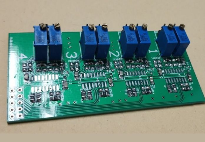

hx711 four-way pressure measurement circuit
This design is a four-way pressure measurement circuit based on the HX711 chip. The measurement principle is that a strain gauge is attached to the sensor, and the strain gauge is added to the full-bridge circuit. The hx711 measures the change in resistance and converts it into pressure. There is a problem with the transistor package on the PCB board and it can be barely soldered.
Circuit PCB screenshot:
