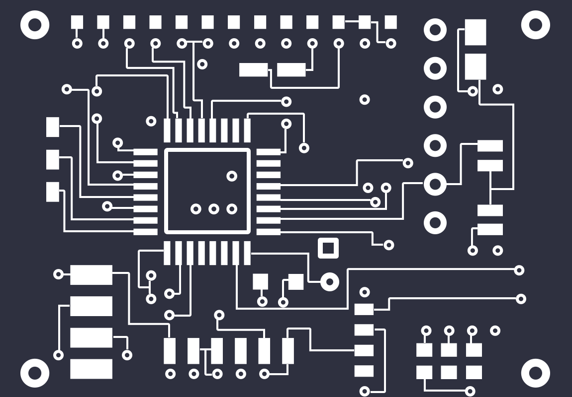

The V1.0 of ejtag was made by netizen FlyGoat. After improvement by netizen Binggee, v1.1 was released. It is said that it supports Loongson 1B, Loongson 1C300B and Loongson 2K1000. It can be used to burn the bin file of Loongson CPU and can be debugged in one step. There is an FPGA on this ejtag, and the EJTAG itself also requires a program to run. The EJTAG itself program (also called firmware) is in my gitee https://gitee.com/caogos/loongson_ejtag

参考设计图片
