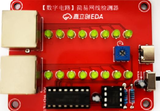

6 Circuit debugging
6.1 Device welding
  First weld the Type-C connector/toggle switch; then weld the resistor/capacitor/LED; then weld the IC socket, never weld the IC directly; finally weld the RJ45 network port and install the M3 copper column.
Figure 6-1 Unsoldered PCB board
  Pay attention to electrical safety during welding. Do not touch the soldering iron tip with your hands to avoid burns. Align the components during welding and check whether the model is correct. During the welding process, pay attention to whether the tin wire is cold soldered or leaked to avoid affecting the circuit performance and causing the circuit to not work properly.
Figure 6-2 PCBA physical picture
Figure 6-3 3D rendering Figure
6.2 Hardware debugging
  After welding is completed, you need to use a multimeter to check whether the power supply and ground are short-circuited, and whether there is a short circuit or open circuit during the welding process. Only after the inspection is correct can the power-on test be carried out. After
      TYPE-C is connected, turn on the toggle switch, the board starts working, and after the crystal heads at both ends of the network cable are connected to the network port, the LED lights up accordingly. Adjusting the resistance value of the potentiometer RP1 can change the LED flashing rate. Then achieve the effect of detecting the on and off of the network cable.
Figure 6-4 Simple network cable detector working diagram
