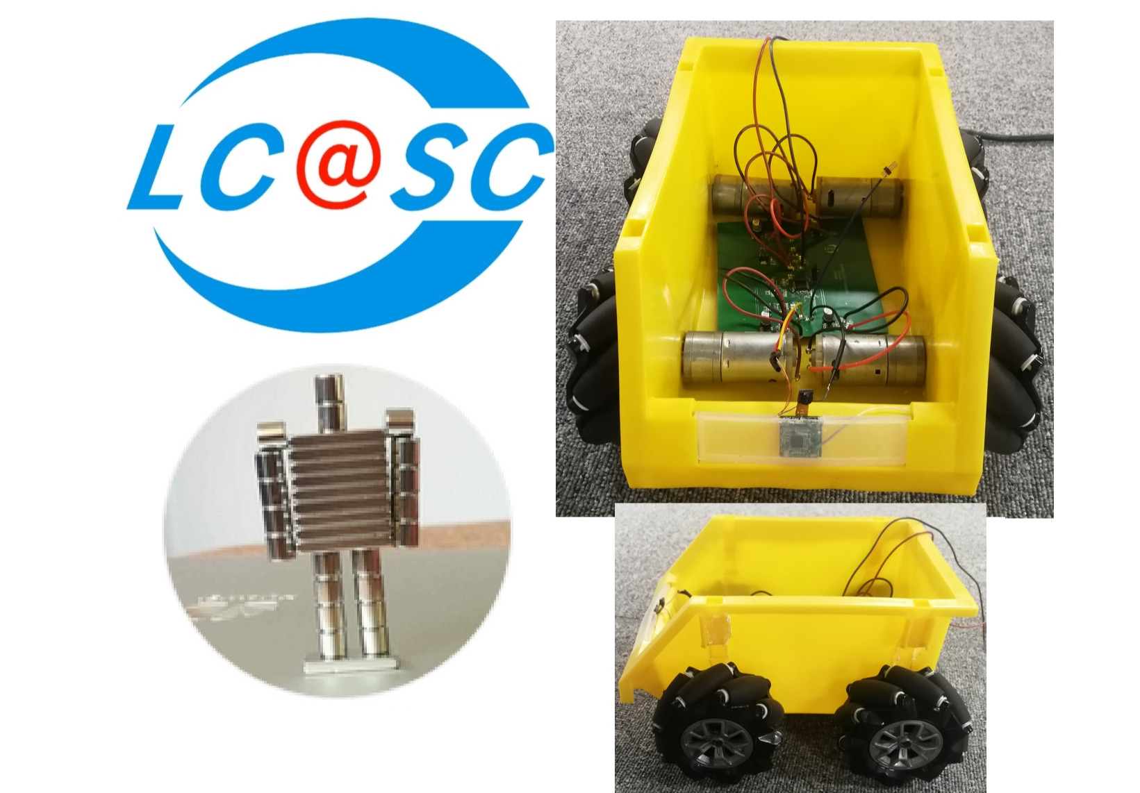

The main components of this project are: wheat wheel, material box diy car body, reduction motor, stm32 main control, wifi camera module, battle FPV app;
## * 2. Describe the challenges faced by the project and the problems solved.
Since the customized car body is relatively expensive, we finally chose the material box as the car body. The price is 3.9 yuan with free shipping.
It is necessary to analyze the protocol of the camera module, serial port output, and conduct the operation on the mobile phone. To operate, capture different protocols, analyze the control part, and write the corresponding microcontroller program to drive the motor;
you need to master the principle of the Mecanum wheel and drive it to achieve the purpose of moving the car in different directions;
currently, the car does not have a battery and uses an external The 5V power supply is directly input, and the battery is used later, and an acrylic plate is placed in the material box for isolation, so that the goods can be placed on the top layer of the acrylic to serve as a transportation function.

## * 5. Project image upload
### 5.1. Print the competition logo image on the PCB. Failure to do so will be considered as giving up the competition
! [WeChat Picture_20200912225116.jpg]
### 5.2. Other pictures of the project
