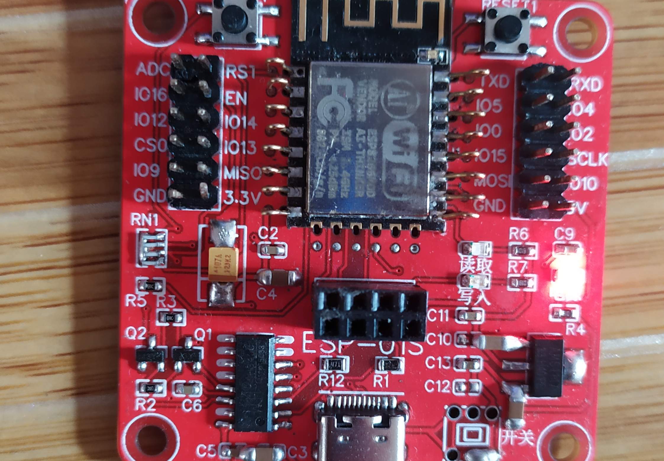

The following improvements have been made:
1. The source file RN1 exclusion has been changed to four 0603, which is easier to buy. The spring pin pad is enlarged to make it easier to solder.
2. The spring pins are removed from the used routing network port pins. There is no cost and there are many at home.
     The elasticity is strong and the clamping is very tight, and the tested welded modules have no problem.
    (You don’t need Taobao’s half-hole needle, stamp hole test needle, or test ring) Save money!
Use tweezers to bend it into this shape, 16 will be enough, and the 6 holes at the bottom can also be soldered (for IO9 and IO10 of ESP12E)
