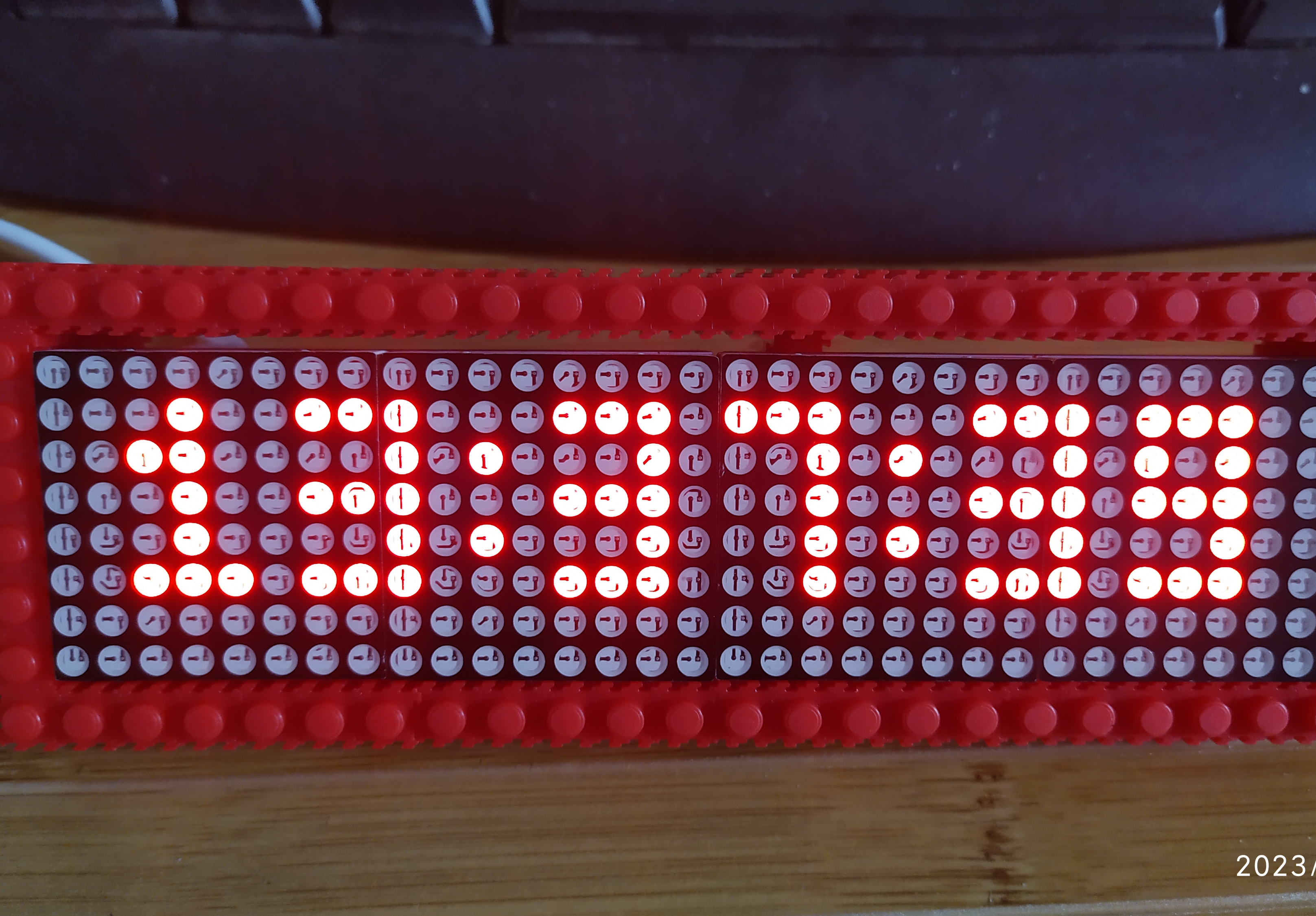

ESP12+MAX7219+1588 common anode matrix clock
Reference project: https://oshwhub.com/Lengff/lattice-clock
Reference blog (with production materials and source code): http://blog.lengff.com/2022/01/17/project-lattice-clock/
github Download https://github.com/Lengff/esp8266-lattice-clock-opengitee Download https://gitee.com/lengff/esp8266-lattice-clock-open
Original author: Lengff Since the board is 10*10, 2 pieces are used The PCB is spliced ​​into one piece and connected with 2.54mm double 5P pin headers.
All components are laid out on a PCB. The typec vertical plug is only used for power supply. The SCL and SDA of the clock module need to be connected to the ESP12F female header (2.0mm dual 8P).
ESP12F is welded on the adapter board
to configure the network applet
