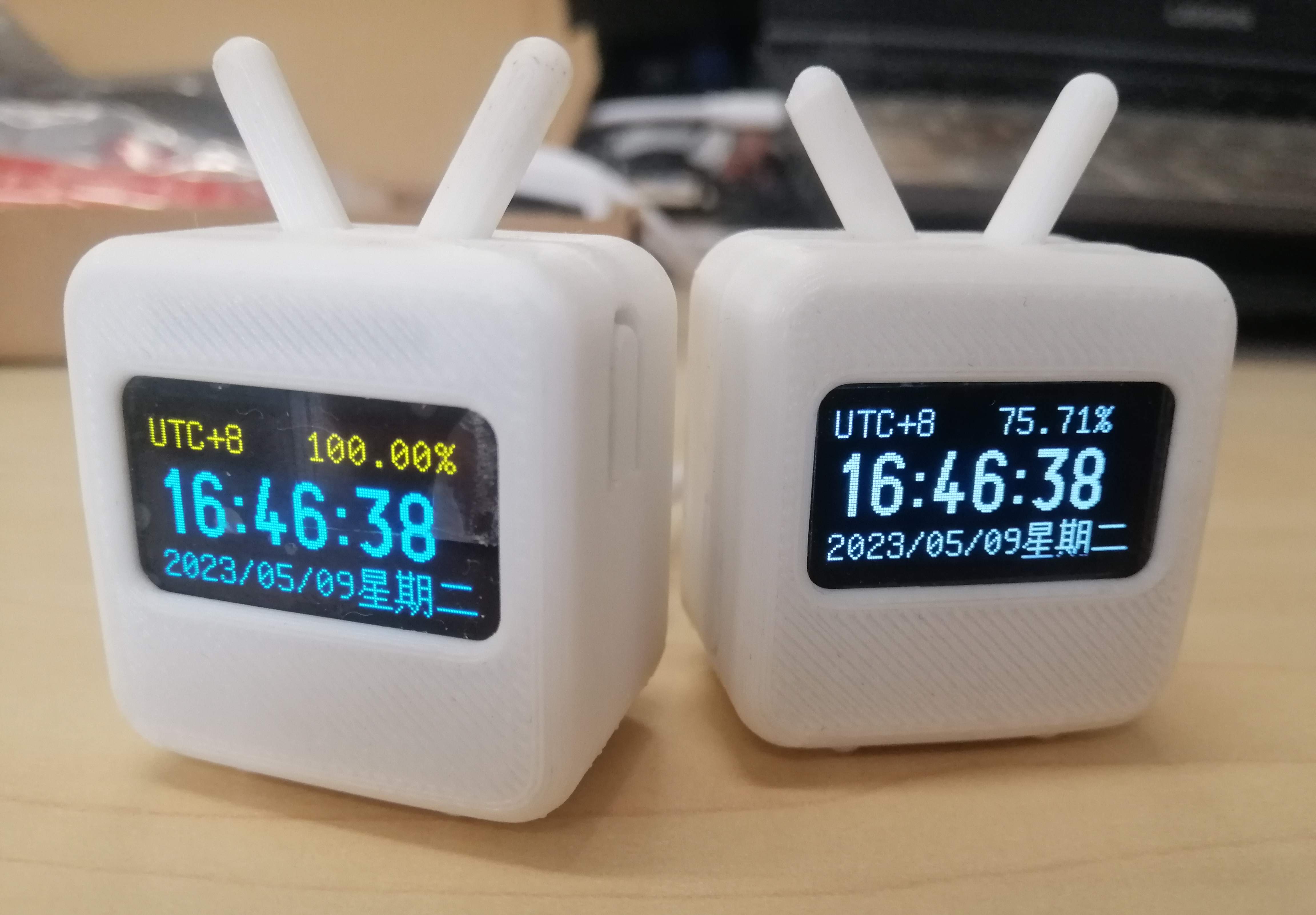

0.96 inch OLED small TV
The code used and modified in this project comes from:
https://github.com/flyAkari/ESP8266_Network_Clock
https://oshwhub.com/nanxiangxiao/esp826-clock_copyPart
of the hardware introduction:
Main control: ESP12F;
Screen: 0.96-inch OLED using 7P Screen display, the screen uses ISP communication, which has a faster speed limit than IIC communication;
Battery: built-in 3.7V-400mAh-702025 lithium polymer battery, with a battery life of up to about two hours;
Power management: uses ETA6003 power management chip, with Dynamic power path management function allows you to always plug it in without worrying about loss of battery life. The indicator light flashes when charging, goes out when fully charged, and flashes when there is no battery;
switch: with battery switch;
power detection: integrated ADC sampling circuit, which can measure battery power.
