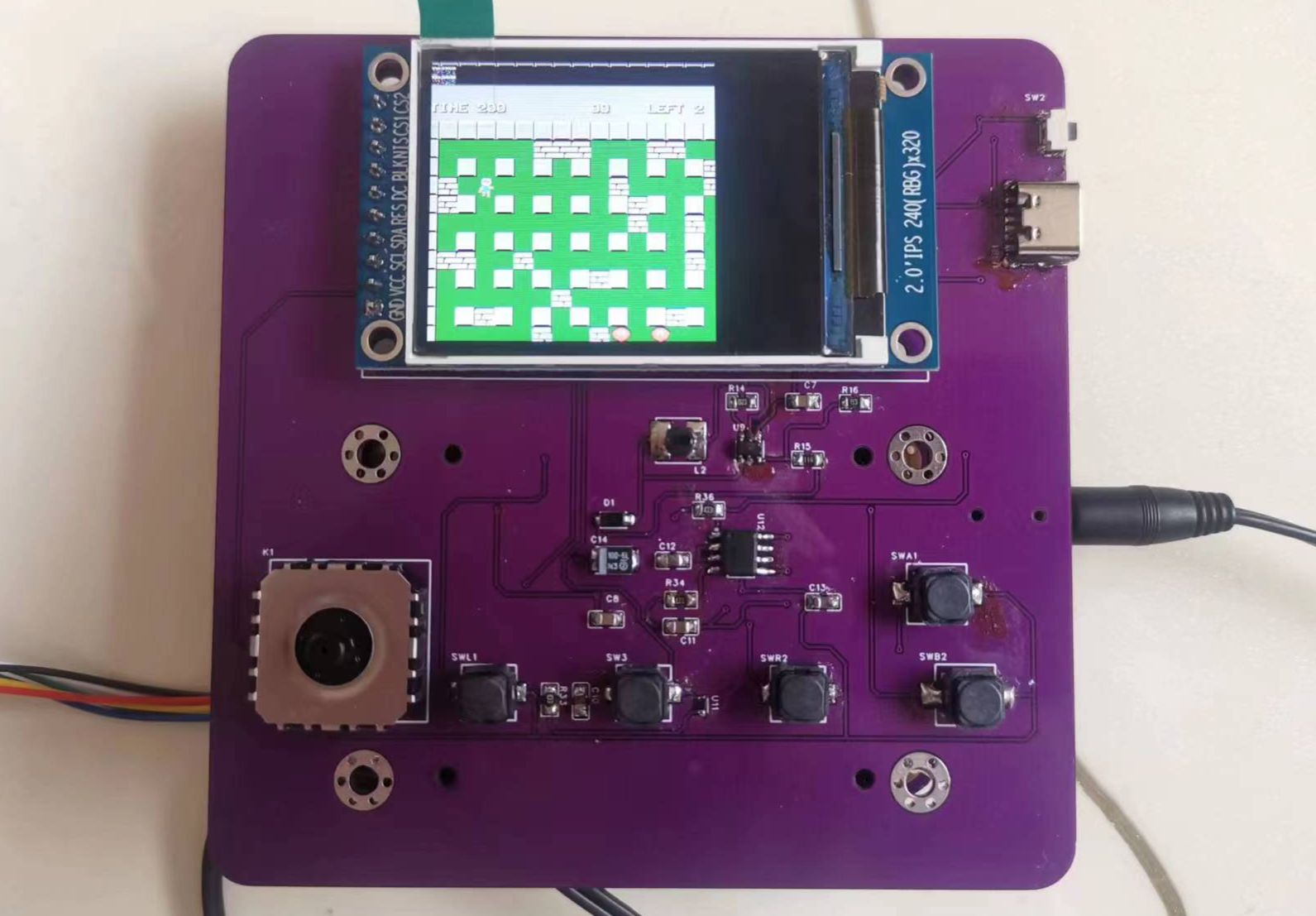

![image.png] ![image.png] **2. PCB design**
PCB design is completed using Jialichuang EDA. The 3D model and final product are as follows
![image.png] ![image.png] ![image .png] ![image.png] ![Front.jpg] ![Back.jpg] The final product does not purchase pin sockets, and the battery power cord is directly welded to the board.
At the same time, there is a diode package that is drawn incorrectly and has a red jumper.
I don’t know how to 3D print the design yet, so the buttons don’t have caps or casings.

![image.png] ![image.png] ![image.png] The final effect
![Front.jpg]
**IV. Summary and shortcomings**
This time, through expansion board design, pcb production, and software debugging, the Learned GD32F470 programming, Jialichuang EDA usage, circuit welding, NES simulator and many other aspects.
The main shortcoming is that I use a screen that is inconsistent with the official one, I cannot simply copy the official program, and my ability to debug the program is limited. This causes display problems when the NES emulator runs nes games in the SD card. I still need to continue to learn and improve. .
