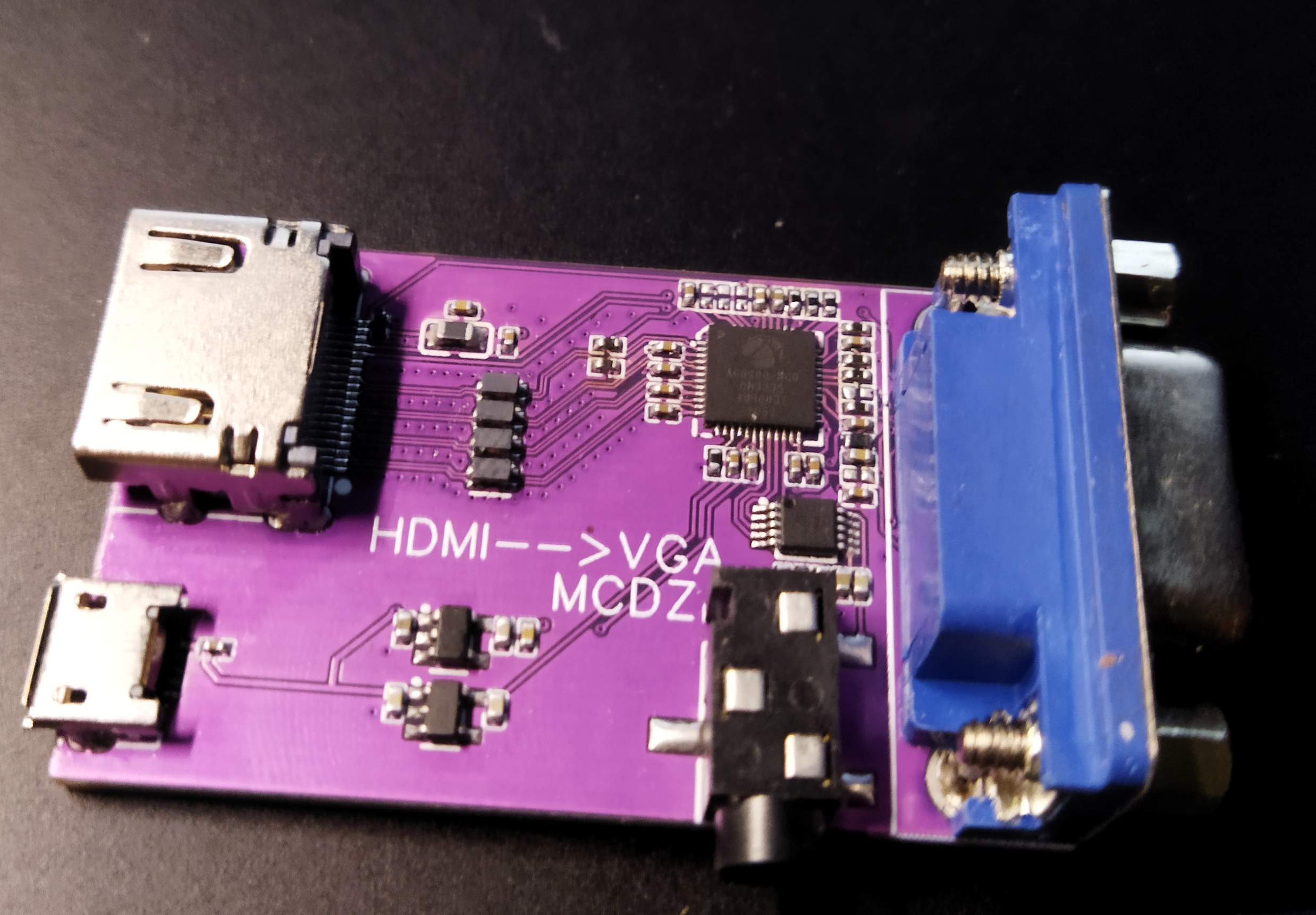

HDMI to VGA one-way video signal converter
The HDMI to VGA one-way video signal converter main control AG6200 is powered by 5V2A. The power supply must be connected otherwise the VGA video signal output will be unstable. It is normal for the AG6200 to heat up during operation, and a heat sink must be added. When making a board, the default JLC ​​two-layer board can be noted as the impedance structure as JLC0216 impedance structure.
