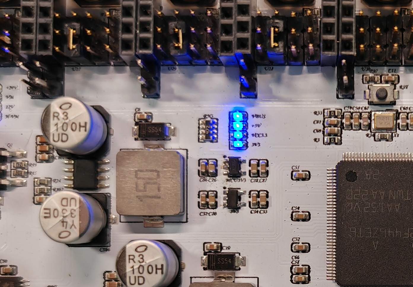

Motherboard parameters
1) Appearance size: 185*100mm 2) Installation size: 175*90mm3) Microprocessor: ARM 32-bit Cortex™-M4 CPU4) Input voltage: DC24V5) Motor driver: pluggable driver6) Motor interface: MOTOR0, MOTOR1, MOTOR2_1, MOTOR2_2, MOTOR3, MOTOR4, MOTOR5, MOTOR6, MOTOR7, MOTOR87) Temperature sensor interface: T0, T1, T2, T38) Display: LCD12864, LCD2004, etc.9) PC communication interface: Type-C, easy to plug and unplug10) Extended interface function support: material break detection, power off and continue printing, shutdown after printing, BL_Touch, etc.11) Support file format: G-code12) Recommended software: Cura, Simplify3D, pronterface, Repetier-host, Makerwar
Physical display
