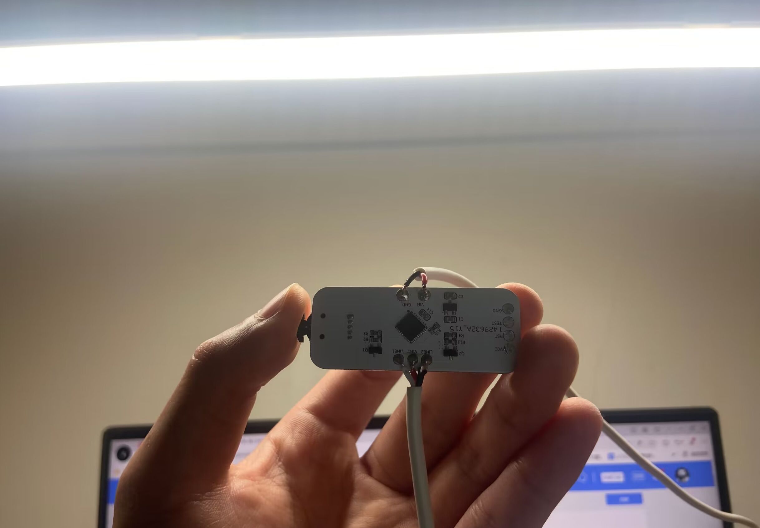

    dormitory is very annoying to use. Every time I have to turn on the switch, switch the color, and adjust the brightness, I have to press 6 buttons every time I use it! It's not user-friendly at all. And I often forget to turn off the light when I go out. The power of this light is 10w, and if I go out for 100 hours, I will waste one kilowatt-hour of electricity. It's a pity!!! So I combined my programming skills that I have practiced for 30 months, and used the original imported chip from the United States to transform the original cool light into a human body sensing light. Every time I walk to the side of the seat, the light will automatically turn on, and it will automatically turn off when I leave. It is very convenient and very heartwarming.

     The human presence sensing controller based on the modified Bull Cool Light can sense whether there is someone in the seat, so that the light turns on when someone comes and turns off when someone leaves, while retaining the dimming and color adjustment function of the original Bull controller. The effect is very good at present. There is no BUG in the code I wrote. Parameter
adjustment description
Human presence sensor model: LD2410B Supports remote parameter adjustment of mobile phone app HLKReadarTool Default
parameters: default light color and default brightness when powered on. You can modify the parameters in the code according to your needs.
