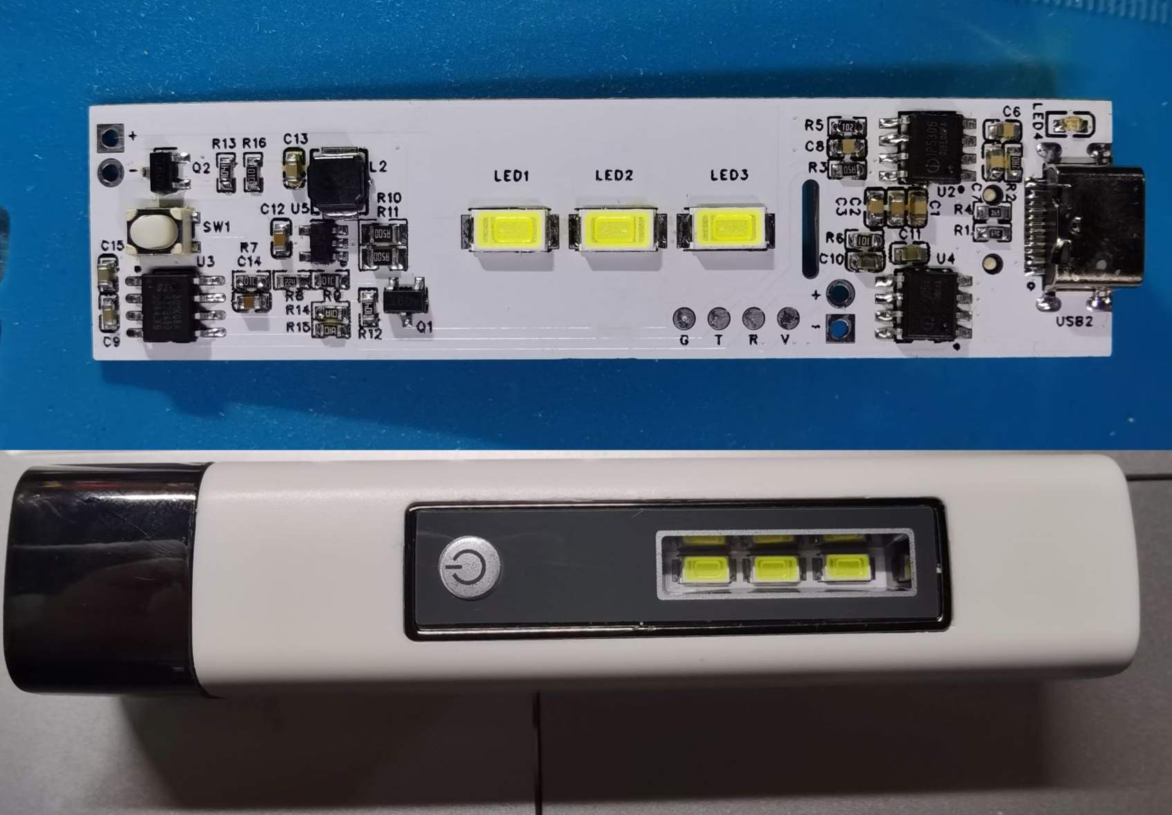

## Hardware-
The shell is based on the modification of the Smiling Shark 867A flashlight, and the charging port is changed to Type-C USB;
- Use 18650 lithium battery above 3000mAh to meet the charge and discharge rate;
- Spotlight single 1w LED (enhanced heat dissipation), floodlight 3 0.5w 5730.
![PCB front] ![PCB back]
## MCU
- STC8G1K08A, SOP8, 10-bit ADC, PWM output, wide voltage range, wake-up from power-down mode;
- MCU main frequency 4M, output 8-bit PWM, PWM frequency about 15.6k, 32 levels of brightness after gamma correction.

## LED driver
- PAM2804/SY8006/LN2401 and other switch step-down constant current ICs, efficiency>90%, hardware design can realize DC dimming and PWM dimming; (actual software realizes DC dimming)
- DC dimming is controlled by PWM filtering to DC and then entering FB. The error is large at low brightness, but the current is small and the light efficiency is higher;
+ PWM is filtered by 1st level RC (10k-1uf), and then passed through 200k-10k and superimposed with current sampling into FB to achieve 10%~100% constant current;
+ The flash mode can achieve higher brightness with >100% current. Since it is intermittently turned on, the heat dissipation can be satisfied; (not implemented)
+ The PWM duty cycle needs to be adjusted in real time according to the power supply voltage to achieve constant DC voltage after filtering;
- PWM dimming can achieve lower brightness. When constant current, the duty cycle does not need to be adjusted according to the voltage. Switch EN or MOS can be selected; (not implemented)
+ The slow start time of switch EN is too long, resulting in a low frequency (<1kHz);
+ When the switch MOS is turned on, there is a pulse current, and a us-level slow start needs to be added, such as using open drain + pull-up drive.
