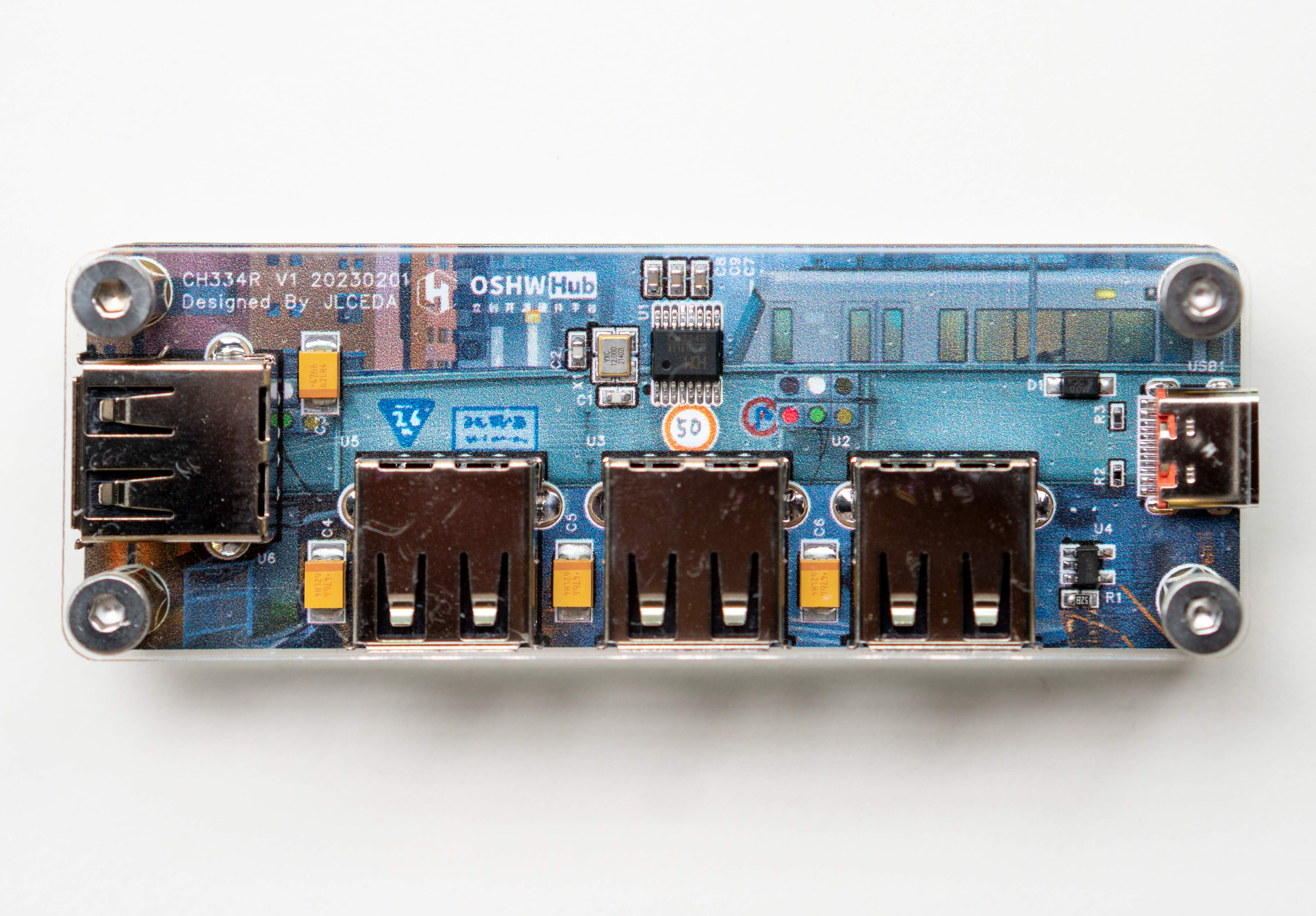

Update log
2023-02-11 Color silk screen version verification completed
2023-02-01 First release

Structure Description
USB TYPE-C input
CH334R USB2.0 HUB master control, with internal 3.3V LDO
SY6280 protection chip to provide power to the subsequent USB
Four USB2.0 female
color silk screen versions
have been completed and can be viewed in the display pictures.
