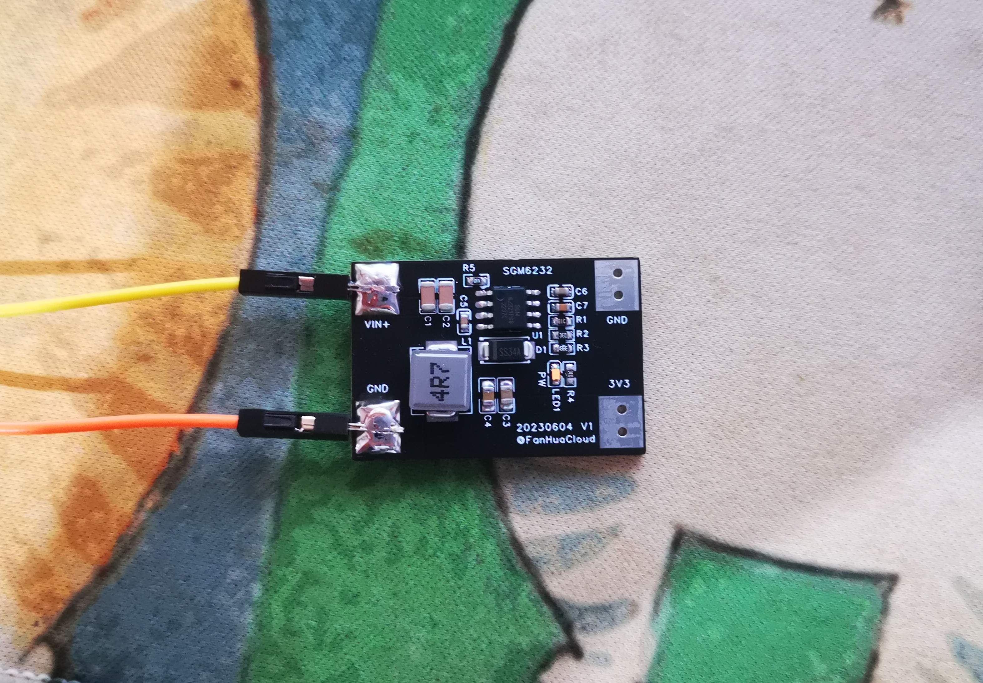

This project refers to the sgm6232 official reference manual and designs a DC-DC buck module with an output of 3.3V.
When selecting
the input capacitor, remember to pay attention to the withstand voltage. For other voltage divider resistors and other original components, please refer to the information in the data sheet:
Diode selection reference, this project uses an ss34
