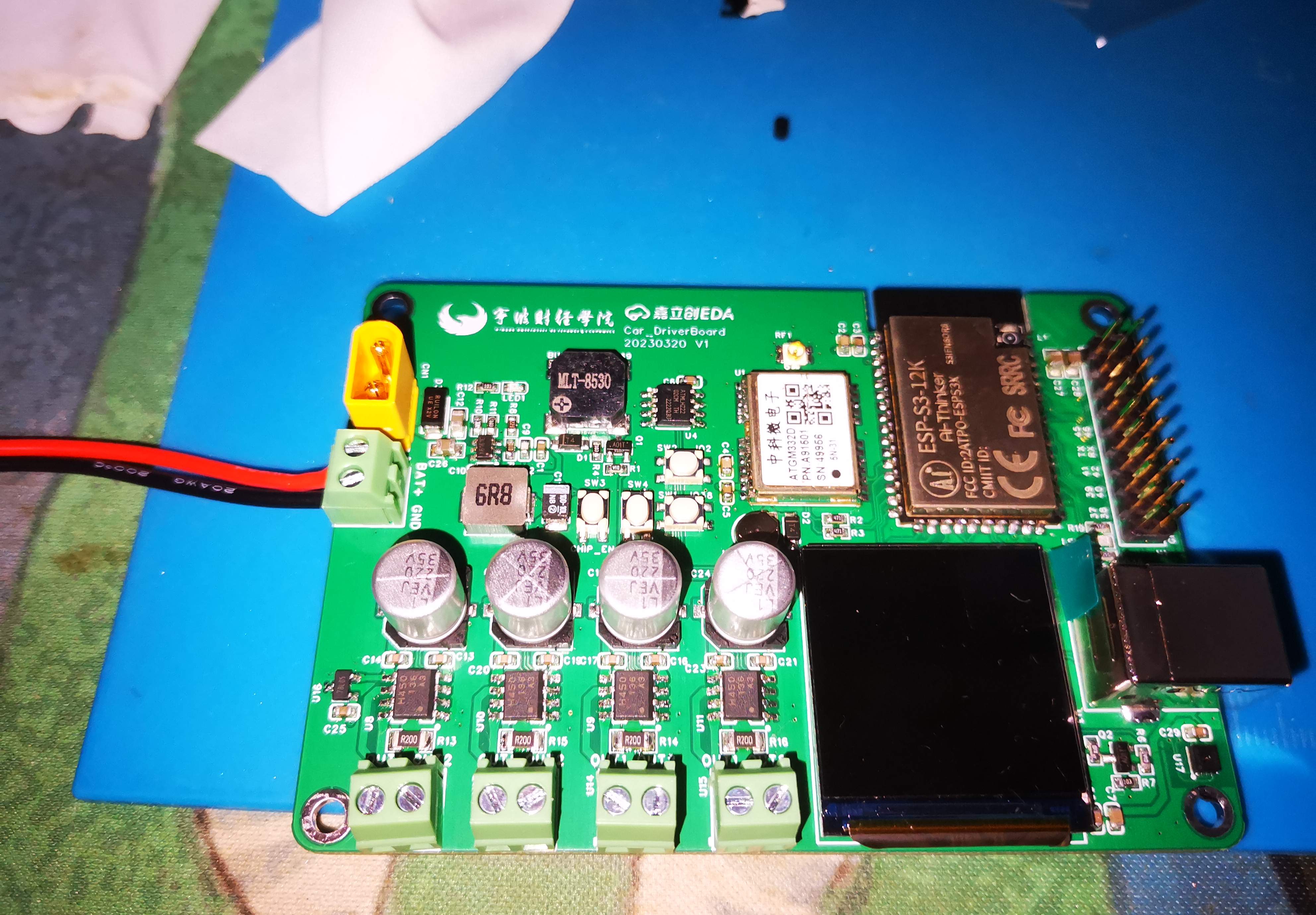

The project written at the beginning
was for the competition. I made a relatively simple car driver board. I considered all aspects and did not go into a closed loop. I used the ESP32-S3 module as the main control and added some additional For some parts, such as GPS, eeprom, etc., you can learn from the
onboard device
main control chip
ESP-S3-12K. The internal esp32-s3 module
GPS module
ATGM332D is a domestic three-mode GPS module that supports Beidou positioning. One AT24C02
EEPROM , used to store parameter display 1.33-inch SPI IPS color screen buck module MT2492, 12V > 3.3V, used for main control power supply Onboard LED lights 1. One power indicator light 2. Two programmable LED lights The test code frontend user control code needs to be compiled using node.js without frontend ESP-IDF code. After compilation, it is burned into the board. The screen purchase link is https://item.taobao.com/item.htm?spm=a1z09. 2.0.0.59082e8dSZxeXU&id=675071235270&_u=s2dklb45da39 matching frame https://item.taob ao.com/item.htm?spm=a1z09.2.0.0.a23a2e8dTCns6n&id=655853023510&_u=s2dklb45 8c23 I bought the "370 wheel without encoder" "Set", it can just fit this board display video https://www.bilibili.com/video/BV1HL411Q7Jw/ display picture
