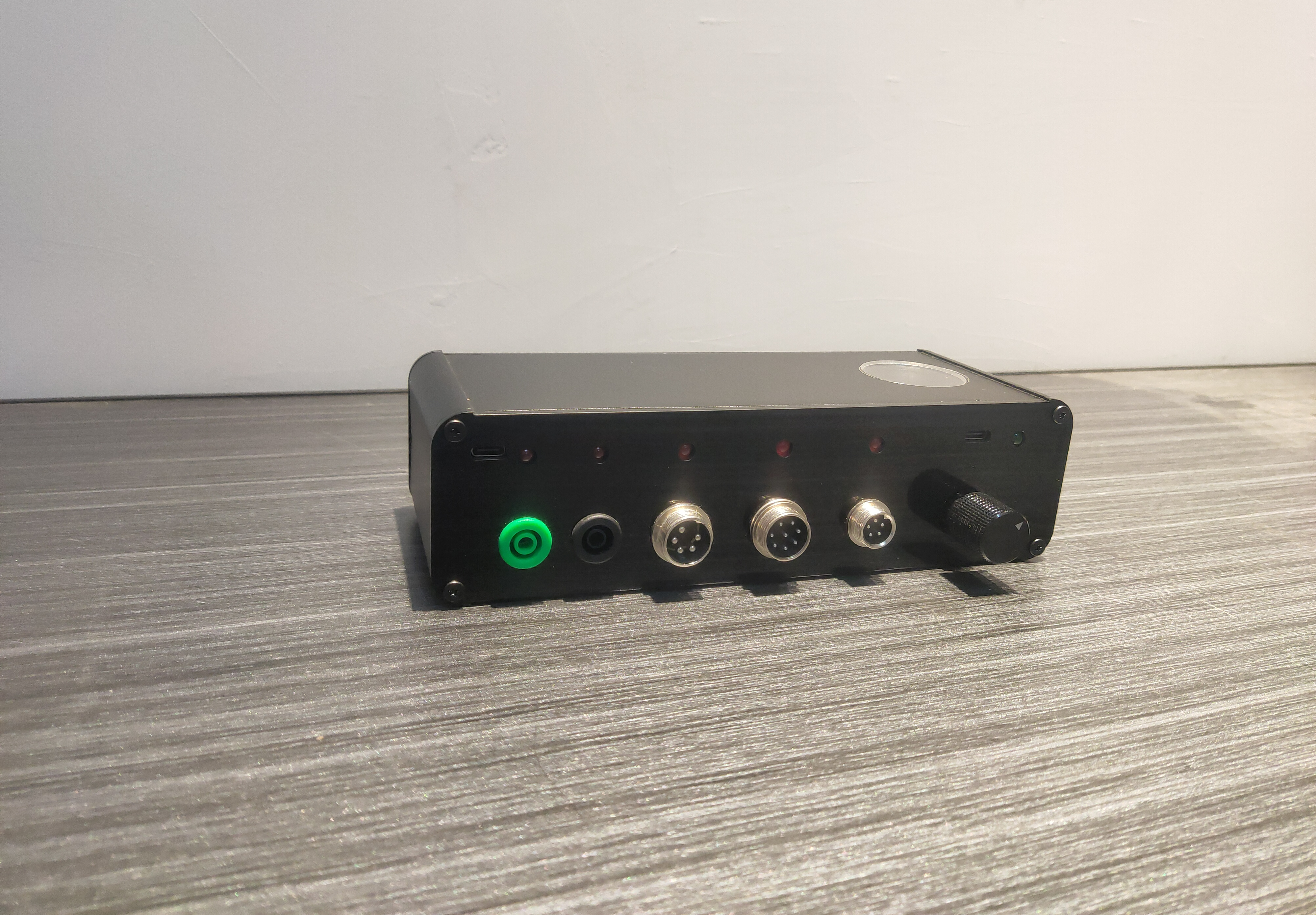

![Complete machine 2.jpg] **In order to clean up the desktop**, the previously made electric soldering iron and heating table were integrated and a hot air qiang and CNC power supply were added to make a **multi-function console**. The console has a round screen and a coding switch as human-computer interaction. The GUI uses LVGL to facilitate the improvement of the interactive experience later. You can also use the type-c interface to communicate with the PC through the serial port (the upper computer software is almost complete recently). The electric soldering iron, wind qiang and heating table interfaces use aviation plug-in mode, and the CNC power supply uses banana plug mode.

The shell adopts aluminum alloy shell sandblasting black, and the overall size is 200X55X70. The main interface is on the front, the power supply and communication interface are on the back, and the LCD display is on the top. A 120W switching power supply and a PCB board are installed at the bottom, and all functions are on this board. Acrylic boards were temporarily made for verification in the early stage of the front and back parts.

![07b661a7b3778386a5e7b6e2b88b276.jpg] ![faa6afcaa7d2c20f84edb03d449c299.jpg] `Wall-mounted mode` directly hangs on the wall, which can save more desktop space, and the power cord can be hidden if there is a socket position.
![Wall-mounted 2.jpg] ![Wall-mounted.jpg] For details, you can watch my video
