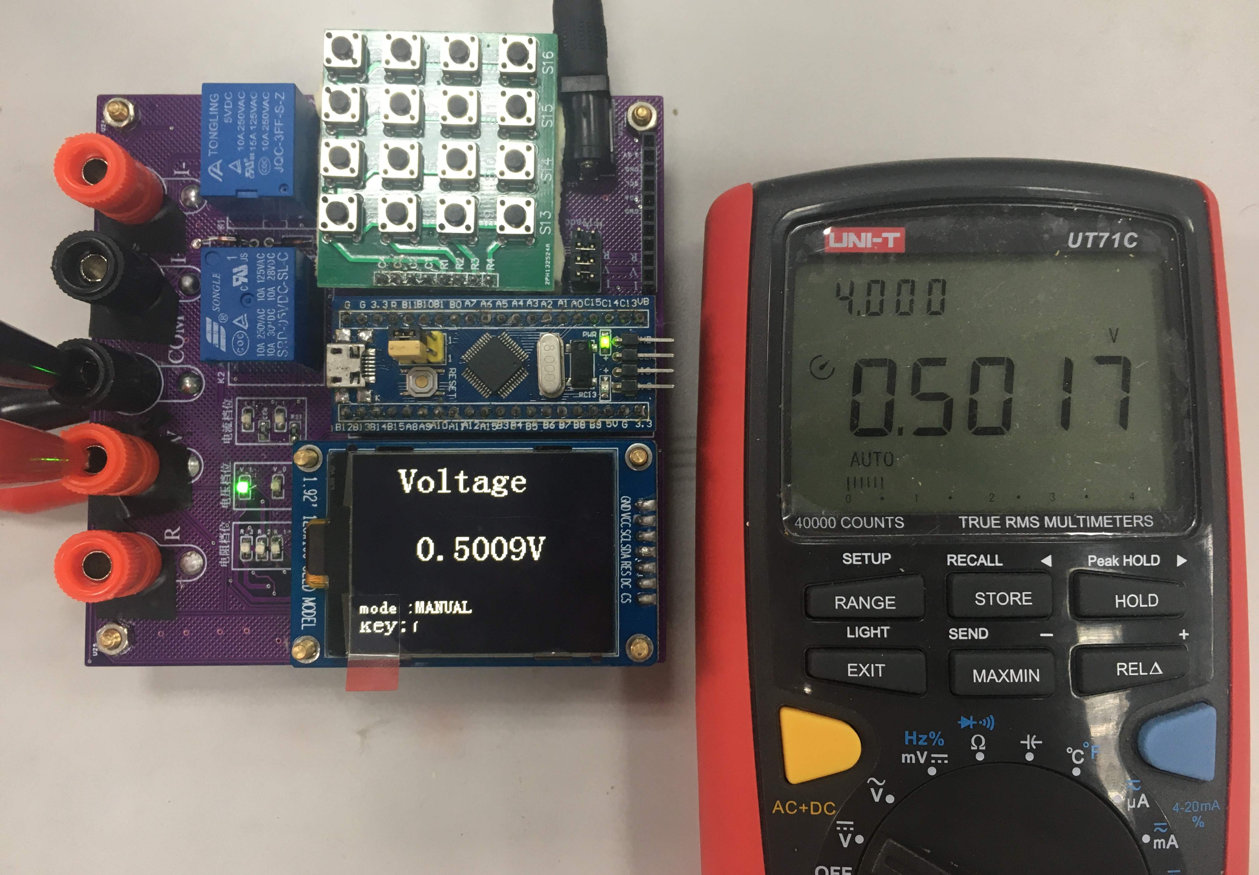

5. Linear fitting correction: By recording the device readings and the standard multimeter readings, linear fitting is achieved through the MatLab program. The fitting achieves a correction effect with a correlation coefficient of 0.9999981, and the accuracy is further improved.
Test results:
The test was compared with the UNI-T UT71C model multimeter, and the average
mode was measured 20 times to take the average value.
The average error
voltage was
0.74%
, current was
0.96% ,
and resistance
was 0.85% . For details on the
