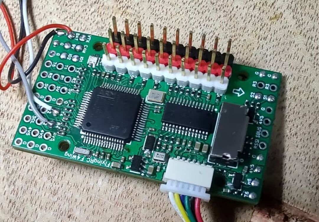

It is a flight control, for fixed-wing use.
Please note that there are two pcb files in the project. The version "gyroscope is on the back of MCU" is the latest version.
This pcb is only a flight control board and must be matched with the power base board (https:// oshwhub.com/hljjmsr/flyingrc-f4wing-mk4-powerdistribution-bottomlayerboard, not common with MK2 baseboard), usb small board (https://oshwhub.com/hljjmsr/flyingrc-f4wing-mk2-usbboard, common with MK2)
Summary of frequently asked questions:
1.ibom packaging issues: Resistor-capacitance packaging is based on PCB, resistance and capacitance values ​​are based on ibom
2.mk4 base plate large inductor selection: 1040 inductor, 3.3uH
3.mk4 base plate servo BEC external MOS selection: NTMFS5C670 * 2
4. Barometer selection, SPL06-001 (compatible with Matek F405 TE firmware); DPS310 (not compatible, needs to be recompiled)
5. Pay attention to the direction when welding the barometer, the hole silk screen inside the pad is the air pressure meter (SPL06-001, DPS310) air hole direction
6. Regarding the use of APM32 domestic alternative chips, there may be critical BUG, ​​please do not use it for actual flight, but everyone still actively tests and works hard to find bugs
7. If you encounter other problems, and Solutions can be added in the comment area.
