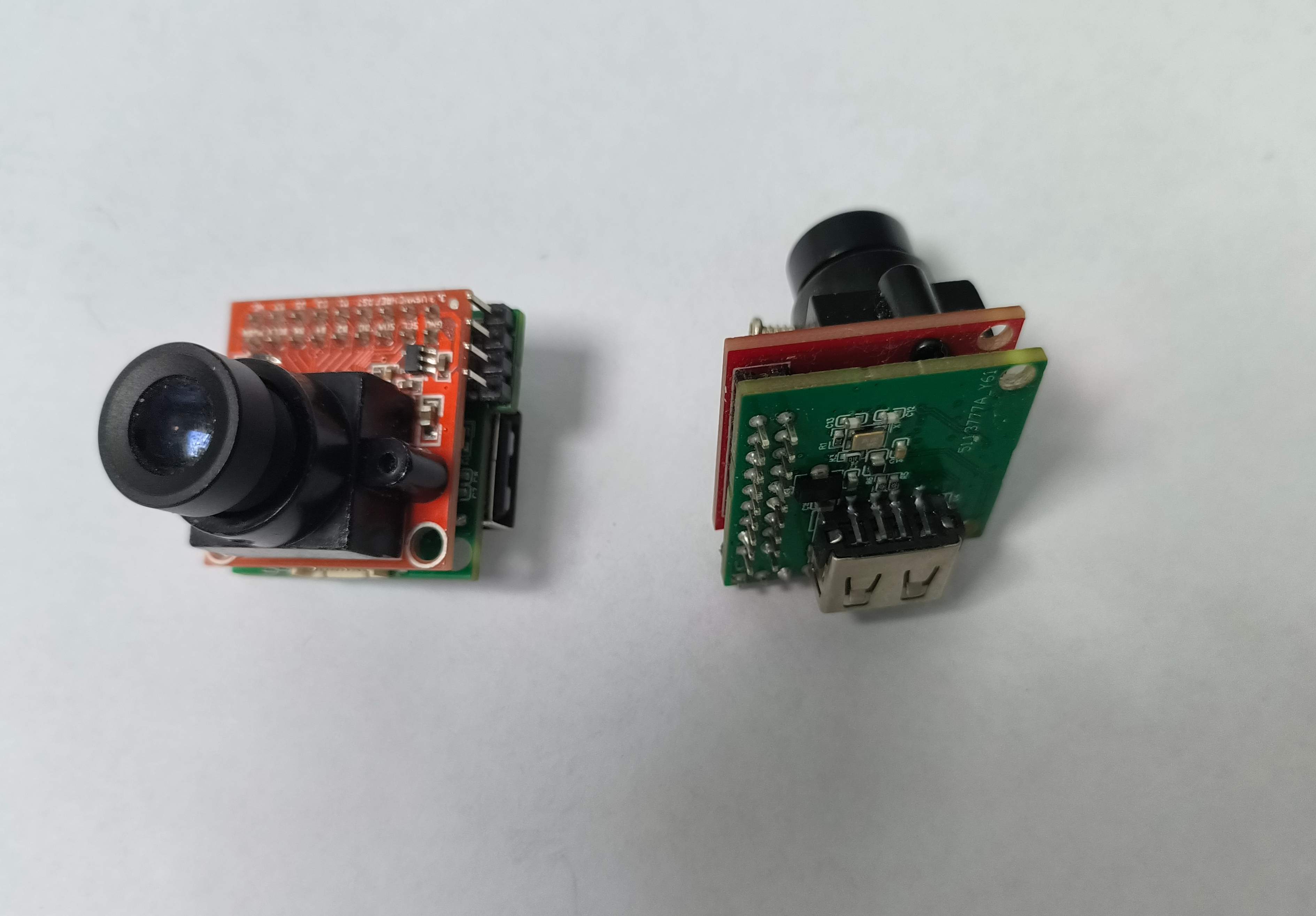

STM32_USBHS(480Mb) camera
1. Use USB to send each line of data collected. Do not adjust the camera speed too fast, otherwise there will be tearing. 2. STM32 QSPI does not support mapping write, plus pin conflict, so spi2 is used. I originally wanted to use spi_psram as cache, but the speed of spi was not enough, so I changed it to spi_flash
