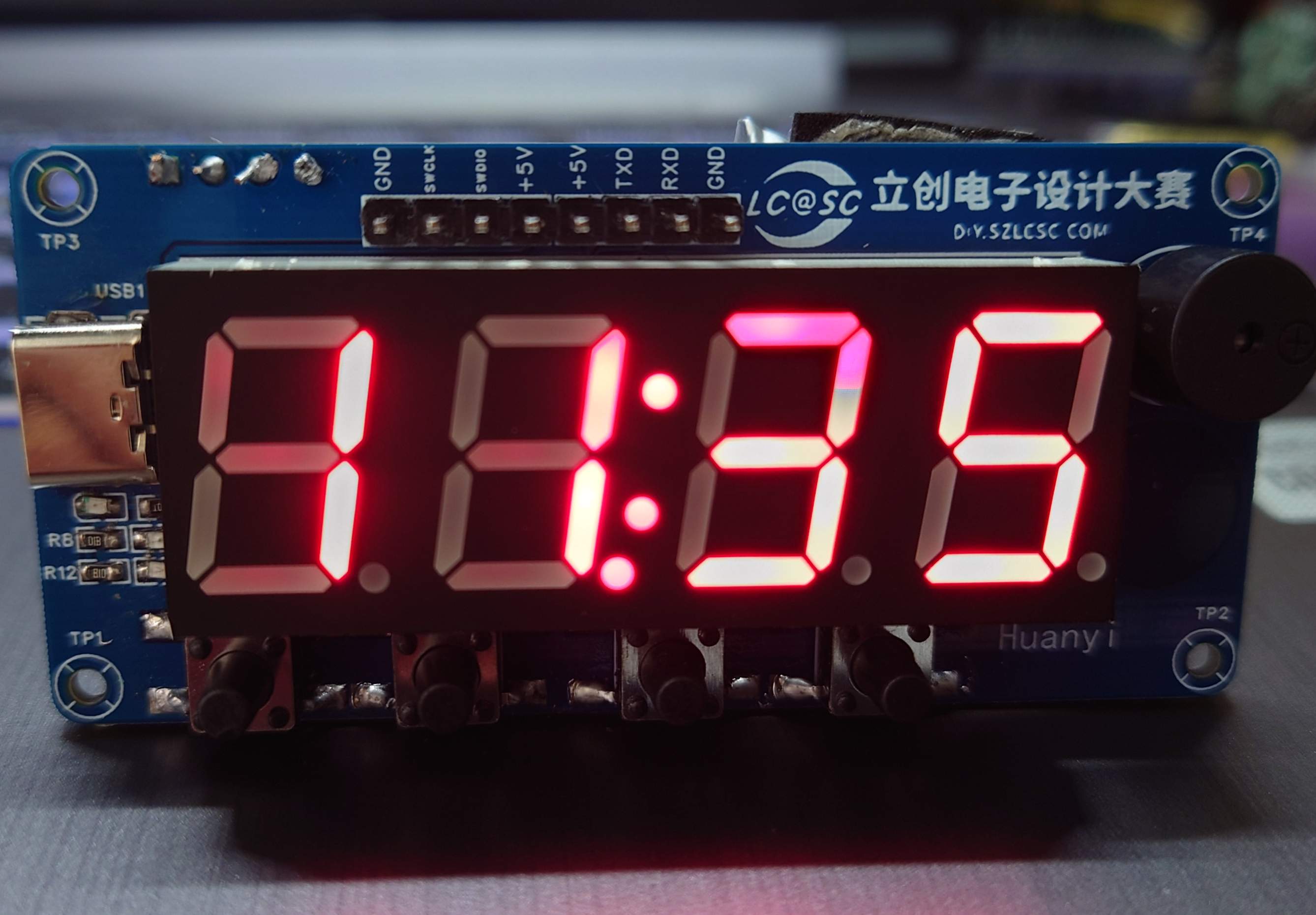

1. Renesas R7FA2E1A72DFL is used as the main control chip of the electronic clock.
2. A four-digit 0.56-inch common cathode digital tube is used to display the time.
3. The ambient temperature is collected through the DHT11 temperature and humidity sensor.
4. Four buttons are used for clock setting buttons:
       long press SW1 to enter the calibration time mode, and the time can be calibrated when the digital tube numbers flash. Long press SW2 to subtract, long press SW3 to add, and SW4 is invalid;
       long press SW4 to switch to temperature and humidity mode (the buzzer sounds once each time it is switched). The first time displays the temperature, the second time displays the humidity, and the third time returns to the time display;
       if the mode is not entered, long press SW2/3 is invalid.
5. Lead out a reset button, serial port circuit, and SWD download circuit to facilitate download and debugging (the project uses SWD download)
6. The Renesas chip integrates a touch pin, and a touch pin is led out to be used as a touch button (the program does not implement this function)
7. Use a passive buzzer as a reminder of time reaching (not added in the program, you can add it if you need it, buzzer.c contains MIDI music functions and functions for buzzer ringing once)
8. Use AO3401A+1N5819 diodes to form a power switching circuit
9. Use TP4056 to charge the lithium battery (red light + yellow light charging, red light + green light charging completed)
10. Use Flash to remember time, and power off to record the last time
11. Power on/reset will have a few tens of seconds of MIDI music playing at one end
