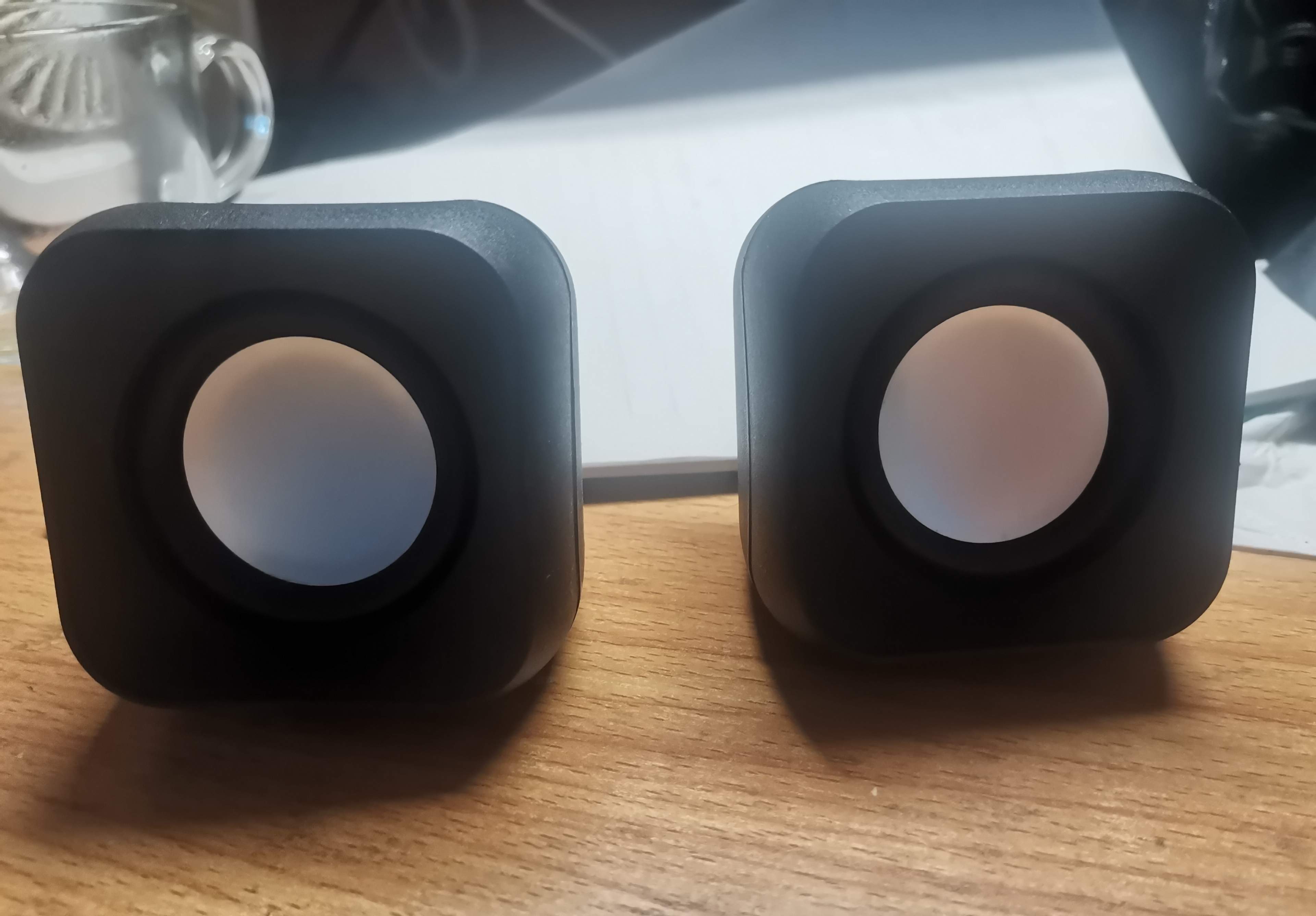

! [pdd.jpg] Promotional picture of a sales platform, priced at 3.8 yuan with free shipping .
This project upgrades the original mono channel and two cables (USB power + audio) to a dual channel, Type-C one-line connection, and adds functions such as WIFI and SD card playback.
