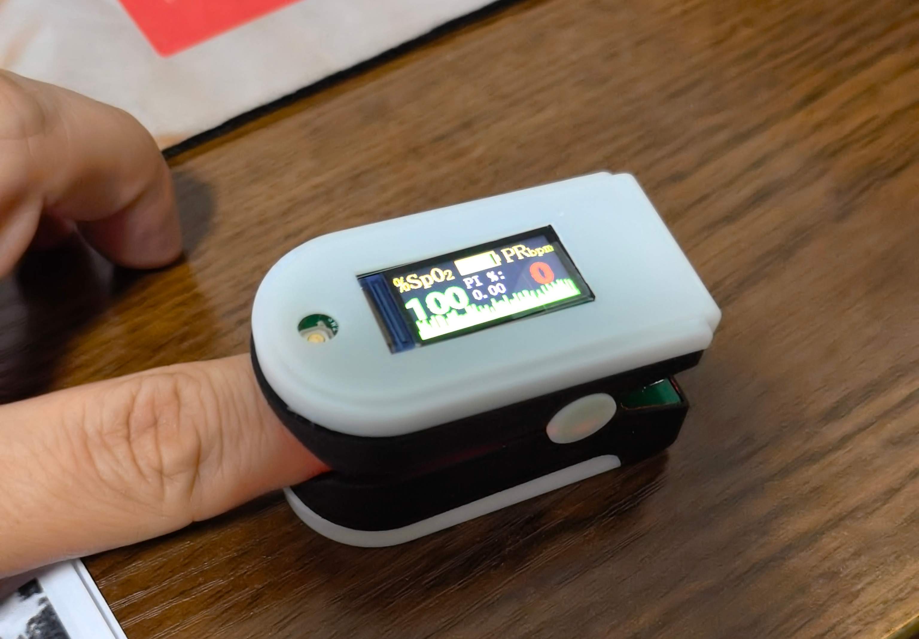

Finger-clip blood oximeter based on CW32L series MCU
Project Description
        This project is mainly based on the CW32L series low-power MCU produced by Wuhan Xinyuan Semiconductor to realize the design of finger-clip oximeter products.
Open Source Agreement
        This project complies with the GPL 3.0 open source agreement and can be copied, modified and disseminated.
Project related functions
(1) The main control uses the CW32 low-power series MCU launched by Wuhan Xinyuan Semiconductor Co., Ltd. to design a high-precision hand-clip oximeter;
(2) Use screen display, it is recommended to use a 0.96-inch TFT color screen display;
(3) Lithium battery power supply, rechargeable;
(4) Low perfusion performance, the minimum can reach 0.2%. (It can ensure accurate measurement of low perfusion patients with weak signals, children, heavy blood loss, cold limbs);
(5) Automatic light intensity adjustment. (The emission light intensity can be automatically adjusted according to the size of the patient's fingers to ensure better signal quality and lower power consumption. Different sizes of fingers and different skin colors can be used);
(6) Excellent ambient light cancellation function. (Can be used indoors and in a clinical environment with strong light);
(7) Can measure blood oxygen saturation SpO2, pulse rate PR and perfusion index PI;
(8) Can flip the screen direction;
(9) Quickly output measurement results in 5 seconds;
(10) Blood oxygen saturation and pulse rate over-limit alarm;
(11) Automatic shutdown when no finger is touched;
(12) Battery power alarm and automatic shutdown when the battery power is low.

Appearance Design
        This design fully refers to the shell scheme of the mainstream brand finger clip oximeter. Through 3D modeling of the existing public mold shell, the appearance design scheme of this work is completed.
Production process
(I) Core material selection
1. Main control The main
        control adopts the CW32L031C8T6 chip produced by Wuhan Xinyuan Semiconductor. The chip has a main frequency of 48MHz, can provide rich on-chip resources, and its low power consumption characteristics are very suitable for battery-powered products.
2. The transmitting tube and receiving
        tube blood oxygen infrared pair tube use 660-905nm dual-wavelength transmitting tube and PD90 receiving tube respectively. Among them, the transmitting tube can emit 905nm infrared light when connected positively, and 660nm visible red light when connected reversely.
3. TFT display screen
        In terms of human-computer interaction, considering the actual size of the finger clip oximeter and the need to display red eye-catching fonts when the blood oxygen saturation and pulse rate exceed the limit to better remind the user of abnormal values, a 0.96-inch color screen is used, and it supports both horizontal and vertical screen UI displays.
(ii) PCB production
1. Production method
        All PCB sizes for this project are within the range of 10cm*10cm, so they can be produced through the free proofing machine provided by Jiali Chuang twice a month. Simply export the PCB file drawn using LiChuang EDA software as a Gerber board file, and then send it to Jiali Chuang through the order assistant to complete it.
2. Physical display
(1) Core board
(2) Expansion board
(3) Power board
(4) Main control board
(iii) Surface mount welding
1. Welding method
        Due to the limitations of equipment and PCB space, a large number of 0402 and 0603 surface mount packaging components are used, so welding is mainly carried out on a heating table. For some direct plug-in components such as pin headers, transmitting tubes, receiving tubes, USB interfaces, etc., after the surface mount components are welded, they are manually welded with a soldering iron.
2. Welding difficulties and precautions
        The welding difficulties are mainly concentrated in the 0.5mm pin spacing.
